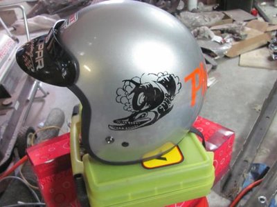

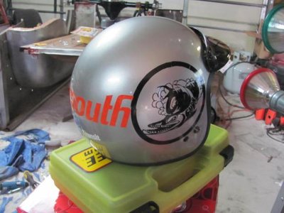

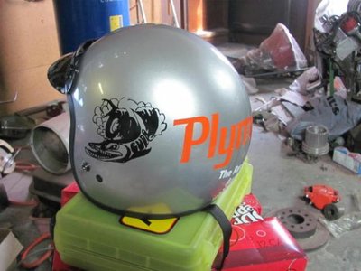

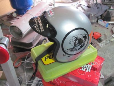

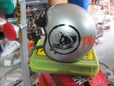

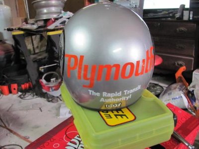

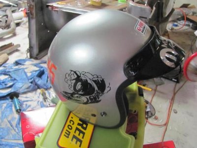

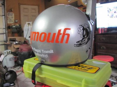

I thought it might be nice to have a helmet that matches the car.
After looking at pictures of the helmet with the circles around the CUDA emblem, I decided to get rid of the circle.

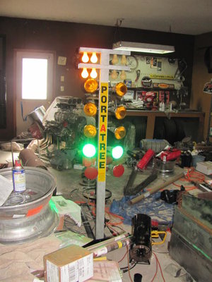

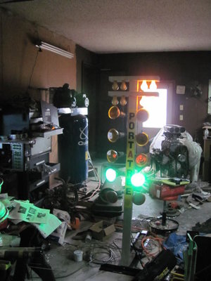

The PORT A TREE that I bought off of Racingjunk.com arrived. This thing's got a lot of options that I haven't figured out yet. It should look really good set up next to the Cuda at the local car shows. :untroubled: Excuse the really messy garage.
IMG_0150.JPG The 2 green lights indicate that both sides successfully left without leaving early and the top lights show the winning reaction time for the right lane.
IMG_0151.JPG Left lane gets the win with the better reaction time. The actual reaction times are shown digitally on the hand held display.
IMG_0149.JPG The left lane has red lighted here and the win is shown for the right lane.

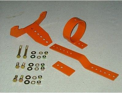

I just ordered a drive shaft safety loop from US Car Tool. We already have one of theirs on our Charger and we were pretty impressed with the design.

No, I cheaped out on the helmet. DOT rated only. I figured I'd use this helmet as a 'starter'. I can use it for display at shows and some of the smaller strips will let you use them. If I get serious, I'll get an SFI approved helmet later. For now I just wanted to experiment with trying to make a vintage looking helmet to match the car and didn't want to invest a lot until I decided on style.

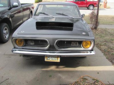

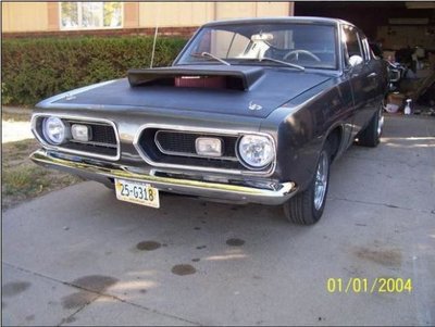

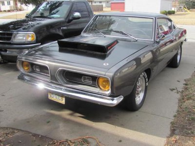

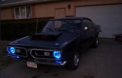

I decided to try something different on the headlight treatment. Because the lights were fairly expensive Halo lights, I didn't want to use a spray tint on them. So I purchased self adhesive colored vinyl film in yellow, blue and orange. I wasn't sure which I'd like best, but I decided to try the orange first.
BEFORE
AFTER

well what do you think....do you like that??...looks great...anyway what brand headlites did you buy?...are they those hid"s?...was thinking of upgrading.....since my headlites are original 1968"s except for one which a rock got from my open trailer

I don't know if the headlights were a great choice or not, but I'm satisfied with them. It's been a while since I installed them and I know they were referred to as H4 lights. They didn't fit my headlight buckets, so I had to enlarge the hole in the back of the buckets. The alignment bumps on the backs of the bulbs did not line up with the indentations on my headlight buckets either so I had to grind the bumps down a bit. These are a non-sealed beam design so the wattage (and brightness) will probably vary depending on the supplier. Mine are noticeably brighter (at least before I added the tint) than the halogens that I had originally. I have heard some people say that lights such as these do not aim the light beam correctly and that they cause more glare to oncoming traffic. All I can say is that I have met my son (that was driving this car) at night and didn't notice any glare issue. I have also heard people say that this style of light puts out more heat and can cook the plug in terminals plugged into them. After using them for a year, my wiring still is OK. The halo is powered by a separate pair of wires that I wired to another switch so that I can choose to turn the halo effect on or off separately from the actual headlights. It might be a while before I give the car a road test after adding the tint. I'm sure it will decrease visibility some. But unless it's an unacceptable amount, I'll live with it.
I am planning on adding a headlight relay system yet to make the system more efficient. These lights draw more power than my original ones did and you can notice it affects the rest of the electrical system when you turn them on. The relay system is supposed to eliminate that issue. I am told that new cars are all designed that way now.
The lights I purchased were similar to these 7".
http://www.ebay.com/itm/111099315751?ssPageName=STRK:MEWAX:IT&_trksid=p3984.m1423.l2649
We also installed a set of 4 on our '68 Charger and had to modify them to fit also. On the Charger we had the same issues trying to get them to fit plus we had to split our headlight rings because the circumference of the lights were too big. The Charger ones came from a different supplier.

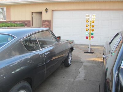

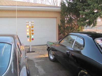

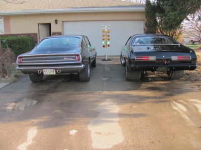

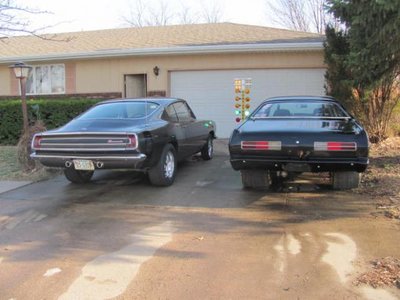

I brought the Duster back into town (from the farm). I figured it would be a good time to check out how the Christmas tree looks set up before car show season starts.
As much as I hate scooping snow during winter, I've decided I need a MUCH longer driveway!!!!
I would have set it up in the street but my neighbors think I'm nuts already.
