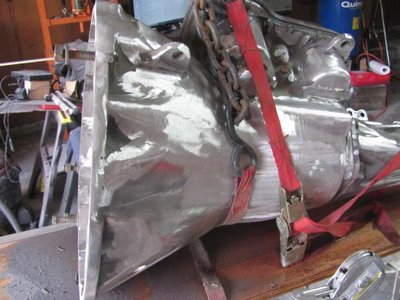

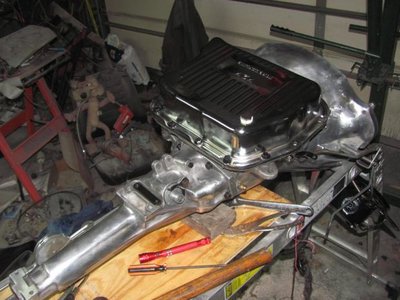

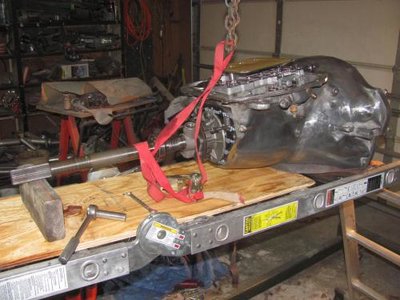

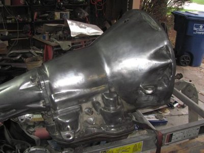

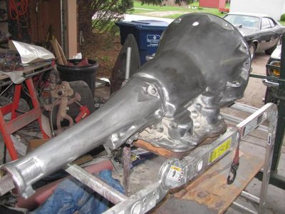

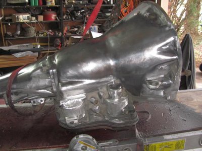

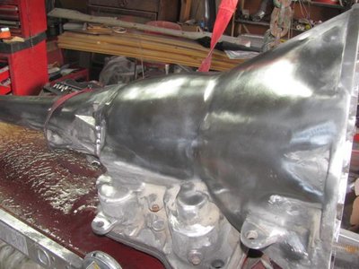

The 727 that I'd picked up in Texas had a relatively rough cast housing. Before I install it I'm going to overhaul it first. - And before I tear into it I've decided to polish the case.
I used a flapper disc on a 4" electric hand grinder to smooth down the casting. Once I'd gotten all of the easy to get to areas, I used a dual action sander to further smooth the surface. From there I used a buffing wheel with the white compound to start bringing out some shine to the surface. The red compound isn't doing as much as I'd hoped. This will not be a professional show finish when I'm done, but it should have a fairly clean appearance. Nothing sucks more than buffing aluminum.

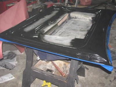

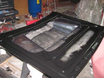

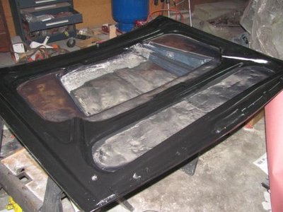

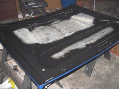

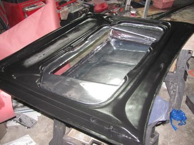

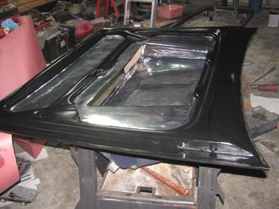

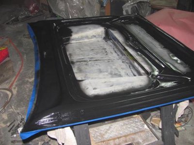

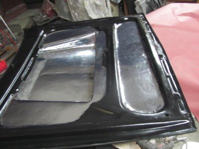

The roll of 'chrome' vinyl showed up. I went ahead and edged the hood. I didn't bother spraying the areas that the vinyl will cover. I figure that if I don't like it and have to peel it back off, it'll probably damage any new paint underneath it anyway. After it's had a chance to dry overnight I'll apply the vinyl tomorrow.
Well, the 'chrome' vinyl does not stretch like regular vinyl. I had expected it to conform to the varying contours. But, unless a surface is perfectly flat - wrinkles form. I thought that heat would help but it didn't seem to make any difference. I put warm water in a spray bottle to wet the surfaces of the hood and the adhesive side of the vinyl. Without it I was unable to position the overlay. I'm not impressed by the end results but it's still a vast improvement over the rough fiberglass finish the hood had before. It'll be interesting to see how it looks when it's back on the car and can reflect the engine compartment.

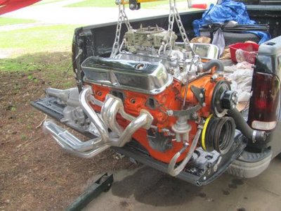

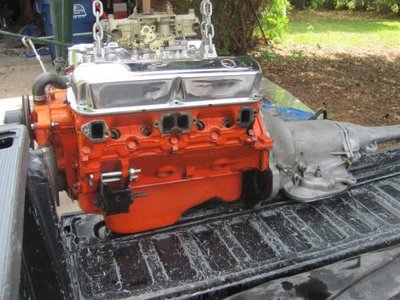

Mike called from MRL today. The 408 was scheduled to go on the dyno this week but he hit a snag. He had allowed me to send him my old Edelbrock valve covers to save a bit on the engine build. - But when he went to put them on this week he found out that they won't clear the aftermarket rocker arms. Unfortunately he didn't have any in stock but is trying to get a set shipped to him this week. So, the engine will go on the dyno next week instead. As always it's been a pleasure dealing with Mike. I appreciate his efforts towards saving me money wherever we could.

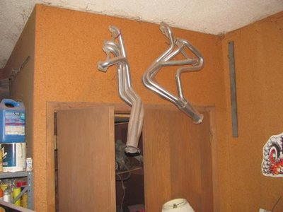

I know I have to do a bit of revamping on the exhaust. I've got a brand new set of ceramic headers that I'd purchased for that '74 e-body hanging on the wall but never used. - And I know I'll have to weld in a bung for the air/fuel gauge. I was toying around with adding in an X-pipe or even an H-pipe. It's been a while so I don't remember the average HP gain you're supposed to get.

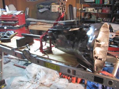

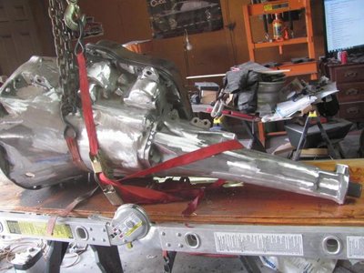

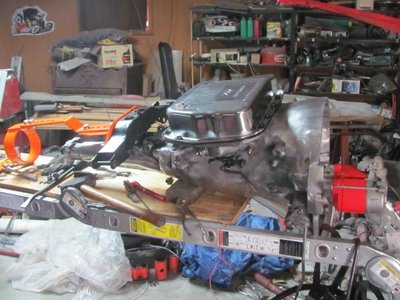

I finally started on the torqueflite today. Now that the outside case is clean it's time to go through it and make sure everything looks kosher. It's been over 30 years since I've had one apart. My memory's not the greatest but as I recall the overhauls were pretty easy. One thing that I am concerned about is the valve body. When I'd bought it an extra valve body came with it. Both were manual but one was a forward pattern and the other was a reverse pattern. The guy I bought it from wasn't sure which was in the transmission. It had belonged to his Dad. I have to figure out how to identify the differences between the two so I'll know what I'm installing.

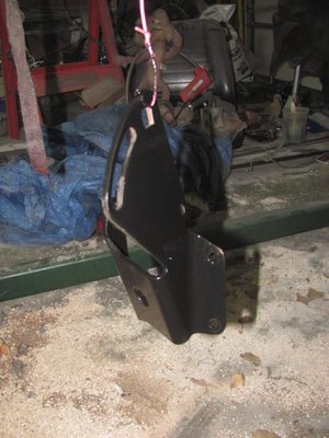

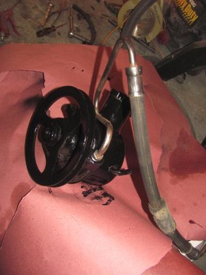

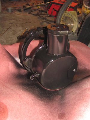

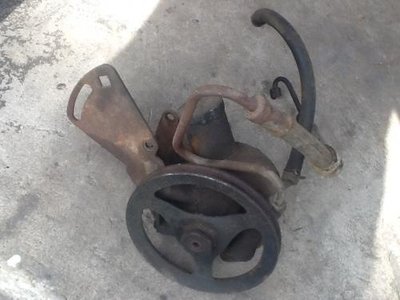

Before I'd stopped driving the Barracuda it began to develop problems with the power steering pump. It chewed up the belt after the pump began to drag. Someone on FABO sold me another one to take care of the problem. I degreased it, stripped off the old paint, and re-painted it. It wasn't caked with grease so I'm not sure if it will need a new seal yet. I'm still considering switching to manual steering before the new motor arrives. I've got to figure out everything I'll need to do the swap first.

When I'd bought the tranny off Craigslist from a guy in Texas a few years back I was told that it was relatively fresh. I had always assumed that they had stretched the truth and planned on kitting it.
As I tore into the torqueflite I was impressed by how clean everything was. It was so clean that I realized it didn't need a rebuild. So I decided to just replace any seals that might have worn or shrunk and re-assembled it.
I looked up the numbers that were on the Cheetah valve body but couldn't get them to cross reference with any numbers online. Then I went ahead and looked up the numbers that were on the torque converter. I was a bit disappointed. Apparently it's a Mopar Performance 2400 stall. It's a definite step up from a stock converter but I was hoping for more stall speed.
Overall I think I made out like a bandit on the deal. The valve body must be worth around $300 and the torque converter listed out for about the same. The internals were in great shape. It already had a deep pan with the filter extension and brass filter. I think I paid $200 for it but had to drive to Waco to get it.

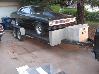

It was late when the Chevelle showed up. He had driven it to Killeen from McAllen. I took it as a sign that the car was roadworthy. It was dark enough that it was difficult to do much of an inspection, and this road trip had drained me. We exchanged cash for title and I loaded the car.

Because we hadn't owned this new trailer very long we were still experimenting with where to position the axles. I decided to pull it down the highway a few miles to where I could get some gas and re-adjust if necessary. It seemed to be a little tongue-light going down the road, so when I stopped I slid the axles further back.
I had a full tank of gas. I'd already gotten both the car and the transmission. I survived the loss of my wallet and the truck breaking down. Now I just needed to get home. I was on my way. The worst was over and I was in the home stretch. - Sort of like in the movie Dirty Larry Crazy Mary.
I drove for hours with that six cylinder struggling to maintain the minimum speed now that the car was loaded. On level ground it did fine but it hated the hills. When it came time to stop for gas again I took an off ramp that curved upward and then turned sharply at the top. I didn't suspect there was anything wrong. I was probably doing 65 when I'd turned off. The sharp curve at the top of the exit wasn't visible from the bottom. When I went to apply the brakes I couldn't stop. The trailer brakes weren't working and the trailer was pushing me up the off ramp at too high a speed. I could see the steep drop off looming ahead as I approached the sharp turn at the end. I was sure things were going to hurt really bad. The truck brakes locked when I tried to use them so I started to hit and release and hit and release them as quick as I could. I was slowing down but still moving too fast. When I reached the top of the exit I bounced the trailer against the curb as it tried to keep going. Fear must be incapable of making me crap my pants otherwise I would have done it then. From the stop sign I crept the truck to the nearest gas station.

Still shaken by the experience I got out to inspect the trailer. What did I find? Apparently when I had stopped for gas the time before and adjusted the trailer axles further back, it had lowered the trailer tongue enough to make my wiring drag on the ground. In the dark I hadn't seen it. I gassed up and headed to a close by Walmart for electrical tape, wire strippers, crimpers, and butt connectors. 20 minutes later I was on my way again. If I was tired before, I was wide awake now.

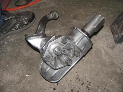

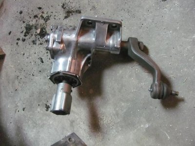

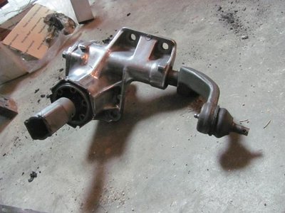

They had a swap meet at the High Impact Performance (all Mopar) Car Show. I didn't buy much but I did get a manual steering gear for $20. It was pretty grungy but a few hours of scrubbing and a bit of polishing and it looks pretty good.

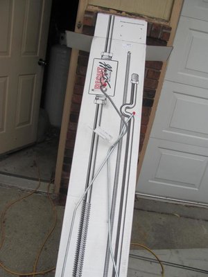

Life is never as easy as it's supposed to be. FedEx dropped off the new brake line today that I'd ordered. I bought it off eBay from a vender called rkmperformanceparts.
It was supposed to be a stainless steel line and I immediately noticed it wasn't. So I read the part number on the line and looked it up on the Right Stuff Detailing website. It won't fit my car. It's a line for a '64-'66 Barracuda. I called Right Stuff up and verified the information and got the correct part number that I needed. After contacting the supplier I've got another line coming. I know that crap happens but does it has to happen so often?

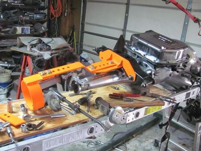

I am verifying that everything is ready by assembling as much as I can before the new motor arrives. The MSD mini starter, linkage, transmission cross member, and driveshaft loop are in place.
One of the holes on the driveshaft loop was drilled undersized and will have to be re-drilled. I'm glad I found that out now before I was under the car trying to figure out why I couldn't get the bolt in.

Now I've got to figure out what to do with this 318/904. I swapped the Edelbrock valve covers for $20 bucks and a pair of chrome replacements.
