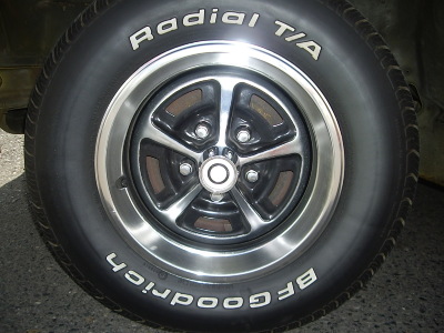

  8. RR383
    RR383 Well-Known Member
    Messages:
    358
    Likes Received:
    Joined:
    Jan 30, 2016
    Location:
    Tennessee
    My 70 runner sports the '69 Magnum 500 wheel....I prefer them. BTW...if one was going to restore them...what silver and black paints are period correct?

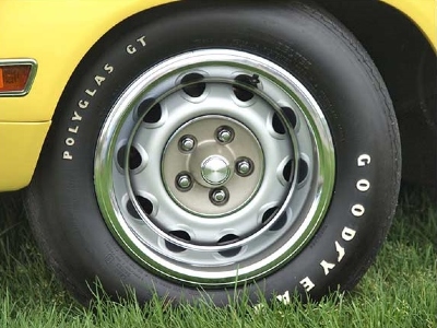

  10. ACME A12
    ACME A12 Plaid Sport Coat Wearing Moderator Staff Member
    Messages:
    12,640
    Likes Received:
    Joined:
    Location:
    That one should have a red brake drum.

  17. RR383
    Messages:
    358
    Likes Received:
    Joined:
    Jan 30, 2016
    Location:
    Tennessee
    Red front drum and or red rear drum or all (4)....really?

  19. droptop
    droptop Well-Known Member
    Messages:
    3,504
    Likes Received:
    Joined:
    Location:
    Any car that was coded for road wheels in 1970 had a 2 inch red stripe painted around the drum so it would show through the openings of the wheel. This was done on the assy. line by taking a 2" paint brush and making a complete red stripe around the drum. Runs and drips are common.
