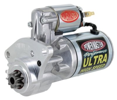

the powermaster is the one I have
Hi 'quick bird', I have one of those on top of my radiator on my Model A hot-rod. The dove is suppose to indicate how QUICK the Model A was for its time...…LOL

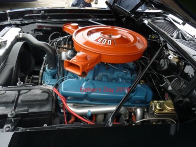

I see you have the 440 block. I have a 1972 400 CI motor. I'm new to all this MOPAR stuff. My '69 dream car is the FIRST MOPAR I have ever owned and boy have I owned cars since getting my CDL in 1963, when I was in the 9th grade...………..LOL

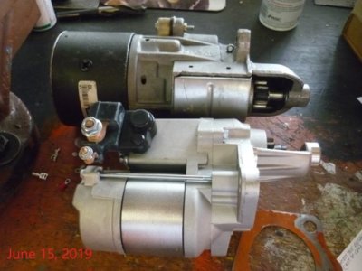

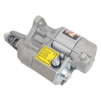

Picture of the 9463 which has the adjustable mount but NO nose cone. Cost $100 more than the 9300 model.

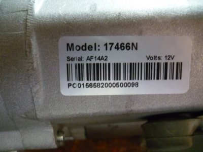

So, I purchased a RECONDITIONED mini high torque starter. The parts guy could not tell me who the manufacturer is...…….running the numbers, it appears to be the same one Autozone sells, "Duralast Gold".

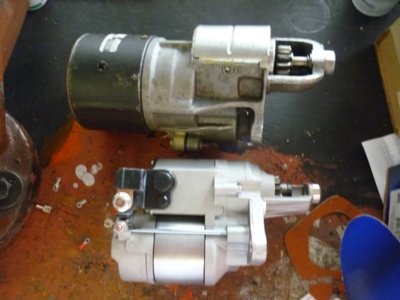

PROBLEM SOLVED:
Not bad, ONLY had to take off the hooker header and do everything TWICE...…...usually, for me, it is at least three times and sometimes four. If I had to do this for a living I would starve to death...………….LOL

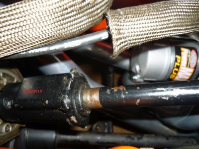

I went with the PWM 9300. It has all that 'black plastic' garbage removed. I can tell you, I ONLY have approx. 1/6" between the starter battery post and the block. That inspection digital camera I purchased a while back is great.
I purchased from "Summit Racing". The salesperson was very helpful and the starter did not take long to get. I highly recommend them.
As someone suggested, make sure you install and tighten the cable BEFORE you tighten the starter to the bellhousing. I was able to retighten the nut since it loosened up on me but it is a very difficult task to do with these headers.
I also noticed that I did NOT see any GROUND cables coming from the engine to the frame. I rather err on the side of too many ground cables. A good ground is also recommended with this starter because it pulls a lot more amps than stock. I installed a good ground as well.
A couple of pictures attached.

A good motor to frame ground is a good thing to have. Found that a lot of cars lost theirs when some one worked on the motor when pulling it. This resulted in lights not working properly and other electrical devices. :thumbsup2:
