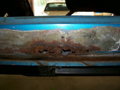

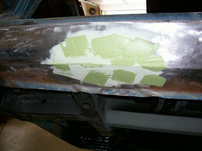

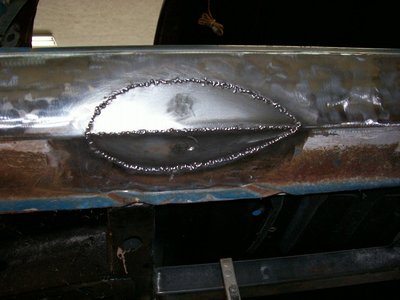

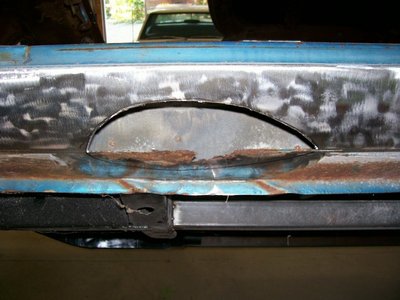

Here is some rocker panel repair. The pics are of the drivers side, but I had to do the same repair on the passenger side.

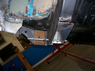

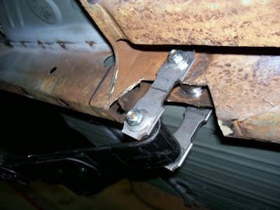

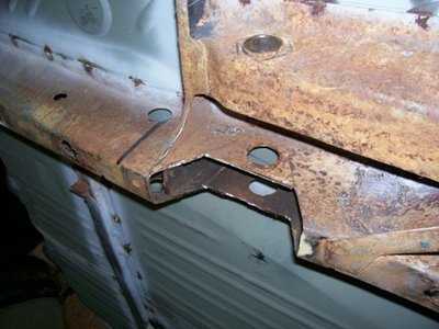

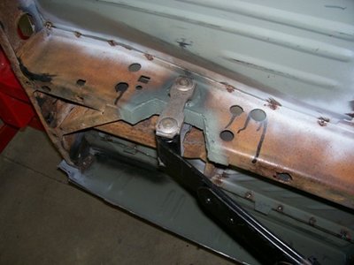

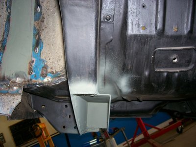

Ok, I got my rear leaf spring hangers in and I did do it a little different than the instructions. You'll see by the pics, but the instructions said to weld the sleeve on the bottom of the frame which would have made it very low.

I notched the frame and cut it on a angle to have room for the hanger to move. I installed the springs to see if its gonna work.

I welded in the sleeve inside the frame with washers on both sides and boxed in the frame. Its pretty much done for now except I need to move the perches on the rear end housing.

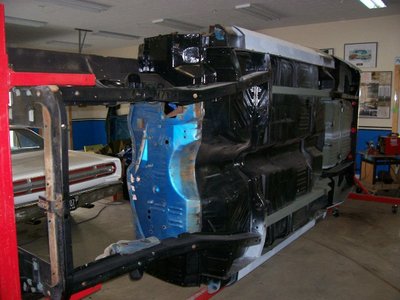

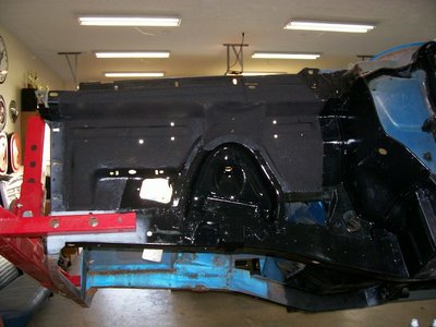

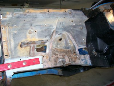

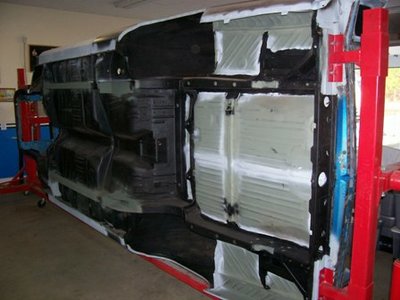

Its mostly rust encapsulator and primer and I'm leaving undercoating in the wheel wells. Next is the engine compartment and I'm going to try and make it look a little better than stock, filling holes, and smoothing it out in places.
ON YOU WELDING MACHINE DOOR THERE SHOULD BE A HEAT RANGE CHART FOR METAL GAUGE .....LOOKING AT YOUR WELDS YOU NEED MORE VOLTS OR LESS WIRE FEED SPEED TO FLATTEN YOUR TACK WELDS..THE TACKS LOOKS TOO COLD....LITTLE 1/4 INCH TACKS EVERY SAY 6 INCHES APART COOLING THEM WITH A WET RAG SO IT DOESNT DISTORT THE METAL......KEEP DOING THIS ALL THE WAY AROUND TILL ITS 100 PERCENT WELDED......ITS ALL PRACTICE
I AM JUST TRYING TO HELP YOU......GOOD LUCK :thumbsup: :thumbsup: :thumbsup:
Yea, sometimes I feel like I'm doing pretty good on the welding then other times its like WTH. Its a learning experience and I can use all the help I can get.
