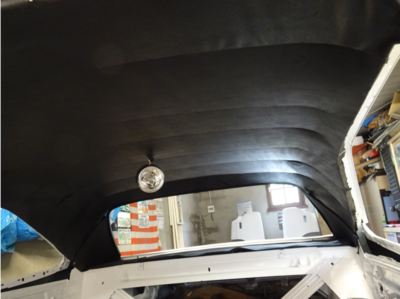

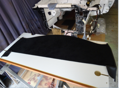

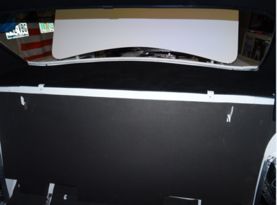

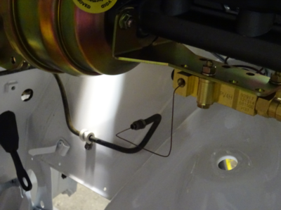

Here is a couple of pics of the package tray personification with the suede stuff, the brake line remolding and the headliner.
We didn't like the look of the package tray, the color look pale ad the surface is not smooth, so we decided to go with a piece of suede we had from a long time ago and was stored in the house, now it looks cool and smooth and the black is a way deeper, nice contrast with the white paint.

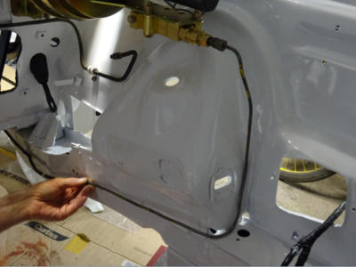

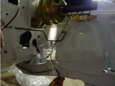

Yesterday we went the brake line guy who said next week we can come back to pick up the new ones. :)

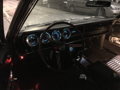

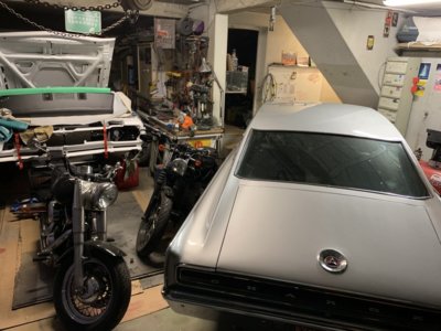

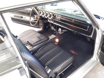

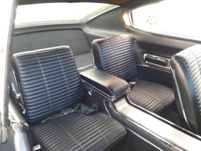

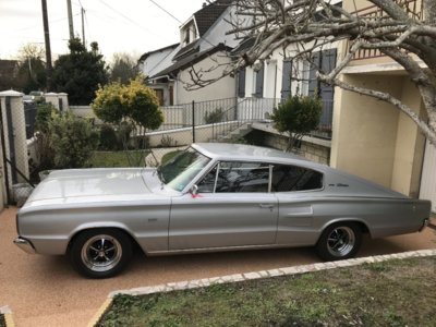

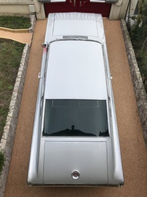

Finally this message is also in purpose of letting you know that there is a new Mopar in town! My brother and I have sell the Ranchero we had in May 2018, and in September we bought a new toy but a real one this time! So the Mopar family just got bigger! We received the car Tuesday.
It is not a bird but a cousin from Dodge. ^^
Let me introduce you to our 1966 Charger 383 4speed from the factory
