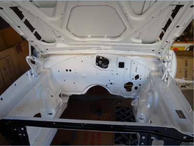

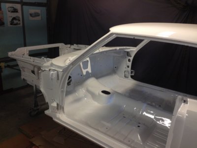

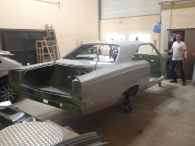

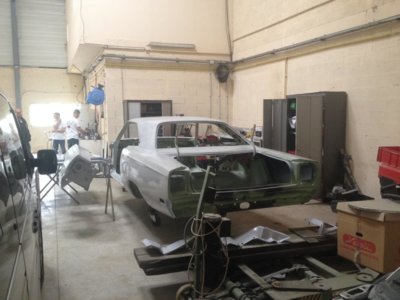

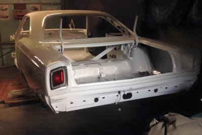

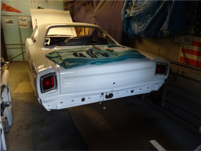

A quick update, the car is finally back from the paint shop and yes she is painted! So glad to have some color on that body shell.
With the car back home, we were able to reassemble the rear, like quarter extension, tail lights, rear harness. For the harness we remove the old stuff wrapping the wires and put a new sheath which is fire resistant and looks a lot nicer. All the harnesses of the car will be re-girdle with it.

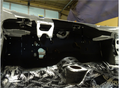

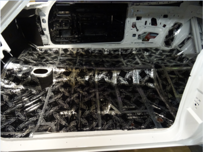

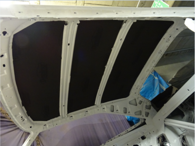

We started to put the insulator inside the car, that part is almost done. The roof is complete, still have to put some heat insulator on the firewall this should be done by the end of the day.

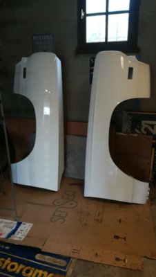

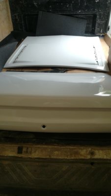

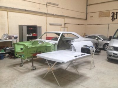

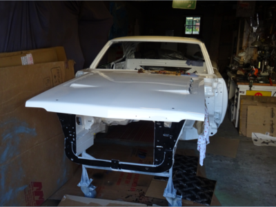

Doors and trunk lid are back on the car, rods for the inside door handle and door lock are back in too.
It is moving along nicely.

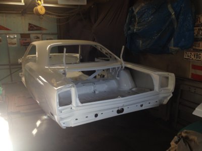

We have finished to insulate the interior of the car, so tonight I'll take some pics and post them here.

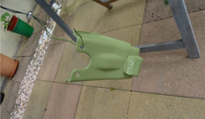

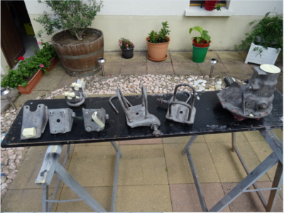

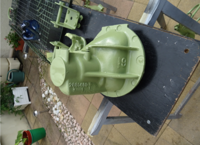

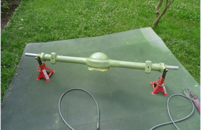

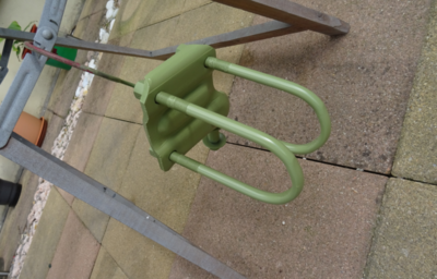

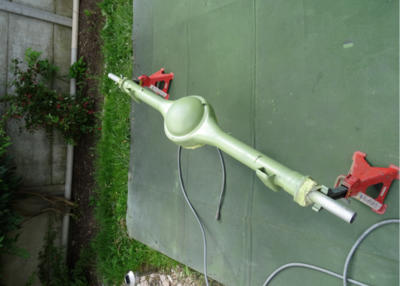

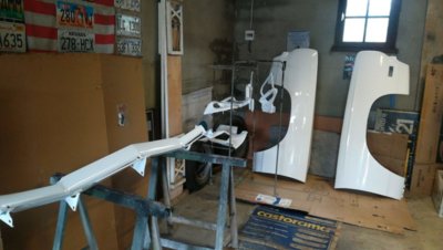

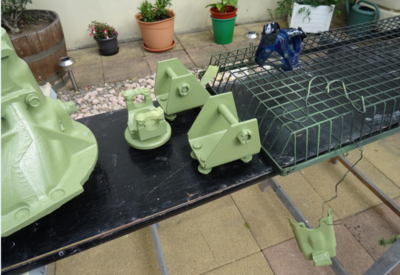

Also have to tke some pics of the rear end and every parts that we have blast sanded and epoxy primed like rear leaf springs the leaf hangers etc etc.

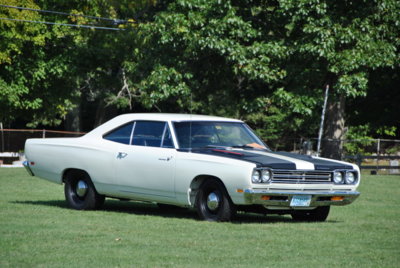

It was Y2 sunfire yellow. But I don't really like that color and I think that the birds look very good with a white dress! :)

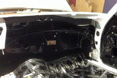

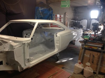

The car is fully insulate now, floor pan, firewall and roof.
Stick some dynamat sheet in the quarters too so it reduces a lot the noise when we shut the door. The before and after test was stunning!

awesome I did not think I was going to like the alpine white but when I got it painted and I put the black stripes on it .I fell in love with it and it is a crowd getter . keep the pictures coming and make a book on all the progress of the car Road Runner 1.jpg
