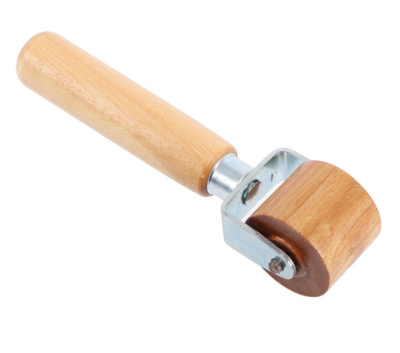

Sixtynine_Bird. I am torn about the peel and stick insulation. Saw some bad review's on the stuff what kind did you get. You said it stuck really well. Did you use a roller to press it down. In one video I watched the stuff had let go on the inner roof. Also was pealing on the package tray. I do think it was some cheap stuff. Well what is you thoughts on the subject. Figure you bought the best material. Russ. :steering:

This is what I used to apply the Dynamat Xtreme :
