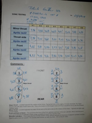

Anyway he sonic tested the cylinder wall of our 383 and he said that it is ok and we can bore it to 60 over. Now it is at 40 but the upper walls have a little ridge I guess this is how you call it.
So it needs to be machined.

That top ring can be cut out and should be. Would not bore it out to much. If bored out too thin it will want to run hotter. I don't under stand if the jug's are uniform from top to bottom Why bore it out another 20 thou. I would stick with what came into the car. 383. Maybe a different set of head's so it can breath better. With a better intake. Don't go with too big of a cam it will run rough. If you are going to make a driver out of it so you can go through a parking lot with out it crow hopping. That is what I would do. Russ.

Russ from what I understood the jug's are not uniform from top to bottom so that is why he told us and verify that the block can be bored out to the final quote. Yes we won't we want t to be a cruiser a well as a killer street machine lol

What numbers give you the thickness from inside wall to the water port's and oil port's. When building a 440 back in the day we had the machines boring the cylinder's. He called us and said that he was getting close. How much more did we want to go. We said keep going. Latter he called back and said he was getting close to the water port's. We said keep going. Latter in the day he called back and said he was seeing day light We said stop. We put the motor together and cranked it up and it would get hot pretty quick. We did this for several day's trying to brake it in. Run it till it started to peg out on the temp. So we asked some of the old guy's we knew and they said put more radiator or bigger. We did that. But still wanted to run hot. So we end up trailering it to where we where going to race it. Would crank the beast up pull it to the line run the race and shut it down at the end of the quarter. Then pull it back to the pit area. It was a beast on the track and back road's. but was not a driver for the road. Two bags of Ice on the intake before pulling it to the line. That motor broke every thing from the motor back. But being young we would fix the stuff it broke and raced it again. Those where fun time's. :thumbsup2:
