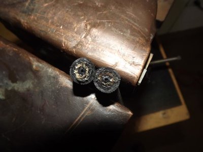

Shall we continue down this unsuspecting road...well used the MityVac with some success. But take a look at the ID of the hose supplying the rear brakes. Not what I would call Kosher...a little undersized don't you agree?

Actually I think that is normal. I was a bit surprised when I changed my front hoses last year and cut them open to check them (having never cut one open, I was expecting a larger hole). They where about the same as yours. Remember, they have to transfer pressure, not volume and those thick walls will withstand a lot of brake pressure.

Maybe so, but this hose was stiff and showing signs of dry rot.
I'd replace it...then you might as well replace the two fronts.

that was referring to my earlier post about the hose being bad.even if this isn't your problem, no harm in replacing a 40+ year old brake part.

You don't transfer pressure...pressure is developed from resistance to flow. The MC by design delivers hydraulic force to the system based on piston displacement and stroke of the piston/s.

Well, maybe "transfer pressure" was not the correct term, but you know what I mean.
