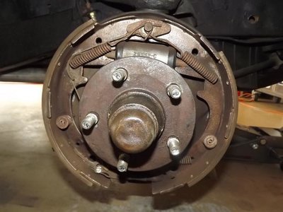

I'm a little confused about spindle/hub arrangement you speak of. The pic shows what this 70 came with. This is right front...which came right off. So again why the resistance on the left drum?DSCF0654.jpg

I'm a little confused about spindle/hub arrangement you speak of. The pic shows what this 70 came with. This is right front...which came right off. So again why the resistance on the left drum?View attachment 10209
That should not have come off that way. I have no explanation why it did other than someone screwed it up in its past life.
The hub and drum... Think of it as one piece.
Chances are you'll want to start looking for a new drum.
Some of the late replacement drums came in two pieces like this. IIRC they were distributed through NAPA. My guess is you have a replacement on the right and the original on the left. Take the spindle nut and bearing out, and it should pull off in one piece.
Wow... I never heard of that one.
Are they still selling them like this??
That is very interesting information. Odd how at some point the right front needed a replacement. Would like to know the rest of the story is this case. I'll get the factory front drum off this morning and check for condition. thanks again gentlemen.
