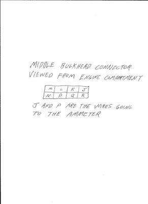

Thanks Jim. Is the other ammeter connection the wire directly beside the large 10 ga red wire?
dobie
2,221
Wooster, Oh
look at diagram i sent you
That's kinda weird. It almost looks like in the pictures there that the large red wire is in one of the end connectors. (top or bottom) Mine is definitely in the middle connector, as in Jim's post above.
