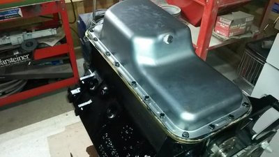

mine has a 7 quart pan, same depth as stock, but longer sump.
