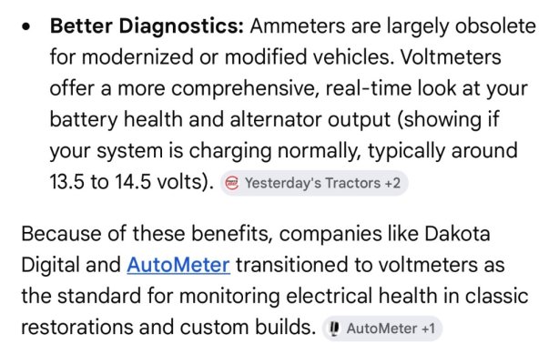

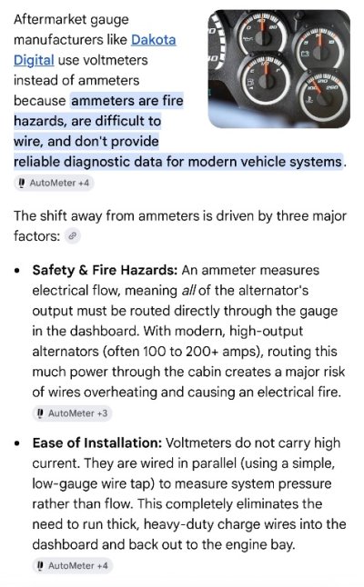

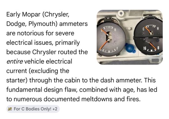

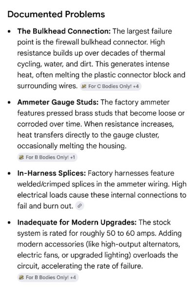

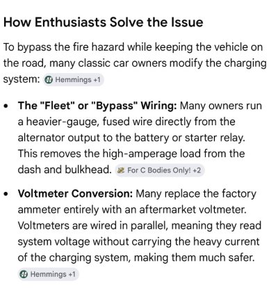

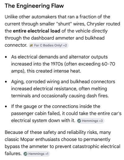

JWW - What exactly is "modern electrical technology"? Your car still has wiring, connectors and fuses. My Barracuda has new forward harnesses but the dash interior and trunk harnesses are factory original and the ammeter is still in place and hooked up thru the factory wiring. Ive owned the car since 1982 and been driving it "restored" since 1996 with ZERO electrical issues. In fact I have owned Mopars since 1979 and NEVER had an electrical issue that wasn`t caused by corroded connectors or some previous owners hack work. I`ll keep mine all factory as designed as they are perfectly fine and look beter than any aftermarket gages.
