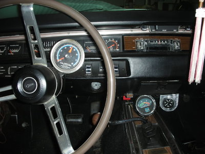

here's my GTX defogger dash shot, defogger is on the passenger side and I have the rear spaker with fader on the driver's side the fader control is just to the left of the reverse light, it also has the 3-speaker dash with am-8track (that still works great!) I can't find my dealer installed one, it's boxed up somewhere.
I like the old Sun super tach :thumbsup:

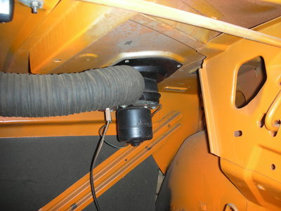

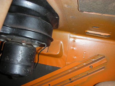

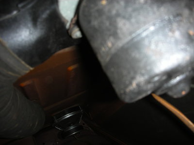

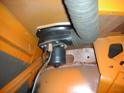

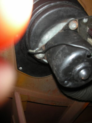

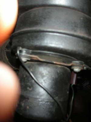

Question, I'm hooking up the wiring for the rear defroster. For those who have this option what color are the wires for it ? I have the original wiring on the switch, it has a red and a black and white bonded together going down the left side kick panel but the rest of the harness from there to the back is missing. Is it just these two wires going to the blower or is there something else. :huh: I have to get the rest of the wiring somewhere as I do not have it in the car. Someone must have removed it before I bought the car years ago. I have several wiring diagrams but only one shows anything about it and it appears to be a black/white wire going into just a black wire at the blower motor. The white wire is labeled as a resistance wire. HELP ! :popcorn: :beep:
mac
What ?
1,396
120
lancaster, new york
ken is the rear defogger a 2 speed? looking at the diagrams and it looks to me like they are using a resitance wire to possibly change the speed. does that sound right? :huh:
V269
Jul 7, 2009
1,156
Ontario, Canada
Mac, yes it is a two speed blower motor and a 2 speed switch in the dash as well. I'm not sure what the resistance wire is for but what you said does sound logical to me. It's just that I have not seen a blower set up before so I am not sure of how it is wired. :huh: Anyone else have any pics or ideas ? :toetap:
mac
What ?
1,396
120
lancaster, new york
well it appears to me that there should be 2 wires (black and a white) that go from the switch to a female connector. then from the corresponding male connector thereare 2 wires (black and a white resistance wire) which come together to a single connection to the defogger motor. then 1 black from the motor to ground. do i have it right so far? :huh:
V269
Jul 7, 2009
1,156
Ontario, Canada
Mac, sure sounds like you have it nailed. This is what my diagram looks like as well. I just have to get the harness to do it. :toetap:
3BIRDS1X
Moderator
Dec 8, 2008
728
Mukwonago, Wi.
Here's the photos, hope they help , if you want the pre-photobucket files PM me and I'll e-mail them out
