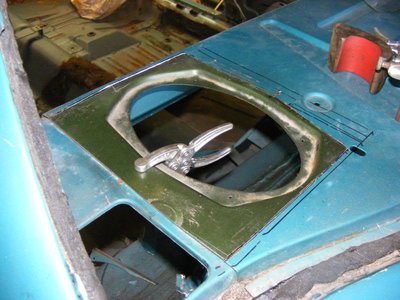

At first I thought "I put 6x9's in the rear of mine and they fit" but then I remembered I had to drill new holes for the speaker on the side where the defroster was.
Mine has 6X9 opening on passenger side and 7X5 opening on drivers side (measured from inside the trunk) The openings in package tray are identical even though the metal cut outs are 180 degrees to each other
Unless they have been altered I believe they all looked like this
Here's the one I've altered.

I want the striped finish you have there
Plastic media blasted, I had to DA sand the whole thing to get the plastic off before prime.
