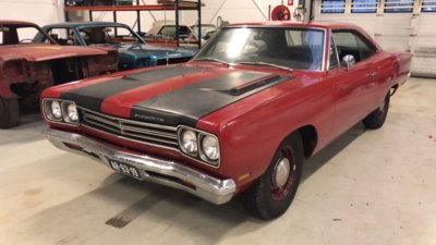

hello,
i am rebuilding a 1969 rr hemi in the netherlands
like the forum and the info

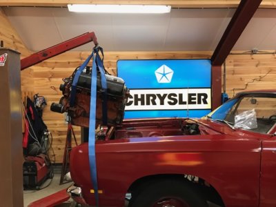

oscar holland
Nov 18, 2018
160
127
It is an automatic
Taking it apart now for repaint
Original collor was grey
