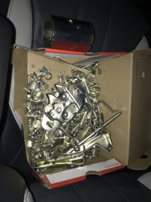

Don't even know if you can get any thing plated here in the USA. Are they cadmium plated. Look really clean and shinny.
22,141
2,344
I can do that zinc plate but some of it should be black phosphate to be correct like the fender bolts and keepers but they get painted anyway

Getting things plates here is getting harder chemical acid bla bla bla....
I know some of it should be black but bling bling and meep meep sound nice

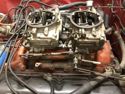

Anyone experiamce with choke’s who are taken off the carb and rebuilding those

Rebuilding the carb's are not that hard. Get a kit and they are pretty straight forward. Soak in a pail of carb cleaner disassembled. Is the choke electrical or vacuum operated. The choke mech I have always bought new and replaced. Hope some one else will let you know if they have the same type of carb's you have that will help. Good luck. :steering:

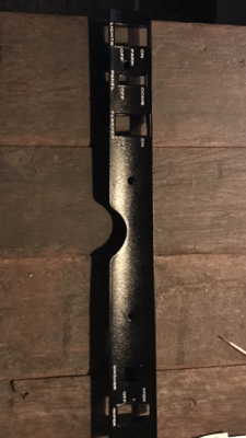

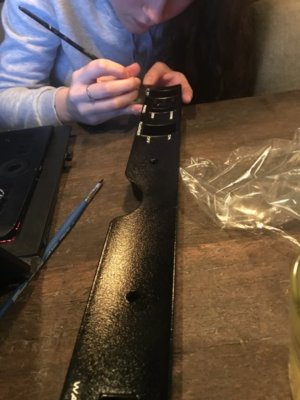

Rebuilding the dash start by making the promis to my doughter to pick her op at 3:00 so she will paint the letters of my dash looks great i think

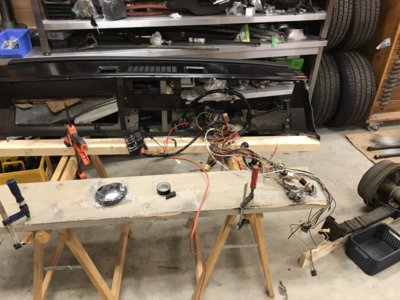

Getting the spagetti right replace all the bad wires and the cuts of the last 50 years unbelievable how well build those cars are

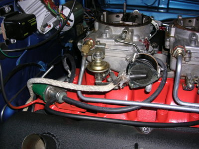

no.JPG The choke uses a spring with a hard plastic bakealite cover and a heat tube from the exhaust manifold
