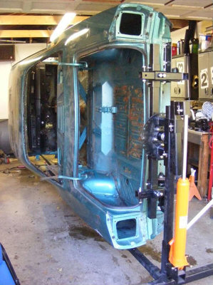

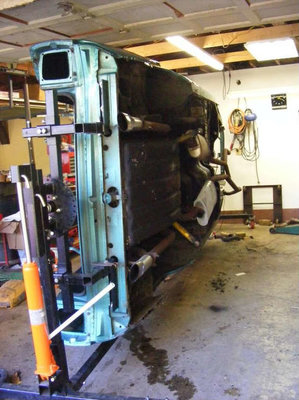

Finally got the car up on the rotisserie today.
Yep. A present from my wife (I gotta great wife!)
Its OK, I'm not real impressed with little things like the threaded holes are powder coated and I've had to clean out a couple holes that weren't drilled all the way through, but it seems to work nicely.
man those are scarey pics. I'd be afraid the body would flop around!
tht seems be be a problem with powder coating. gotta tap out the bolt holes, and any place where parts go together.
Hey Big, are you taking the car down to bare bones?
The car is really down to the bare bones. I left the gas tank and exhaust pipes on (they're off now) until the car was on its side because I figured it might be a little easier to take off.
The only thing in the car right now is the dash.
There's one spot under the drivers feet that needs to be replaced, the rest of the floor is pretty solid. I did find a spor today under the passenger seat that looks like someone jacked up on and I think that can be straightened.
The big thing was the underside had been painted fluoresent orange at one time. I just covered it with rattle can under coating. I want to finish it nice.
The rest of the car is pretty good, except the rear quarters really need to be replaced. They were patched at the very bottom years ago and done the way we did them back in the eighties. I think it made things worse over the years. I'm going to go with the AMD panels.

That looks like a challenging project you have there. Do you have a lot of sheet metal to replace? Oh, btw, I like your emergency brake(s)!

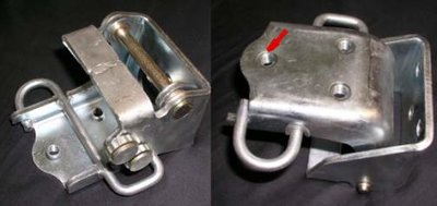

hey Big, were the hinges you got new or used? what are they going for.pretty sure I need one lower.
and that looks like a pretty good projet. keep the wife happy, and she'll let you play.
thanks, I've bought from Ehrenberg of of ebay. (BTW,you must not have been awake yet :huh: , your link was for page 5, took me a while, but I found the ad on page 10.The search on moparts sucks)

BTW - I had the hinges for the Swinger reconditioned by SMS Auto Restorations in Champlain, NY. They do a nice job...costs more than R.E.'s new hinges...but they are reassembled with self-lubricating bushing...
Just another option for hinges...
