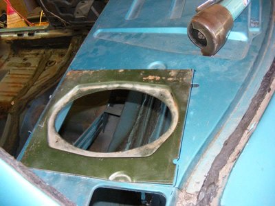

OK.. I decided I really needed to accomplish something positive on the car to get me going again so here's what I did this afternoon.

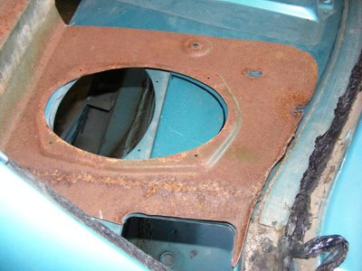

I alays wanted to have 2 6x 9" speakers in the rear, but as we all know, Chysler wanted to only have one and a hole for a defogger. I had a rear speaker section donated to the cause from someone at the old forum... but I can't remember who.
First I flipped it over and saw it was pretty much symetrical. There's a slot, a hole and a cut out that mirrors the right side.

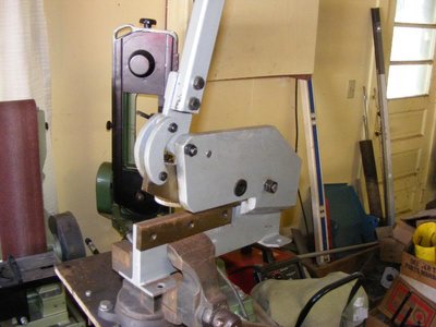

I cut the new section down with my handy throat shear. This is the greatest thing since sliced bread.

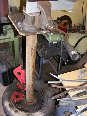

Another really handy piece is this vise mounted on a piece of 1" steel and bolted to an old driveshaft welded to a wheel.

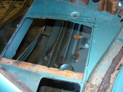

I roughed out the hole.

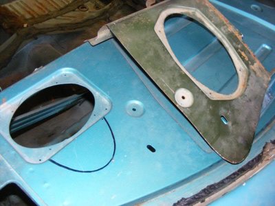

Put the new section in place to get an idea where to start cutting.

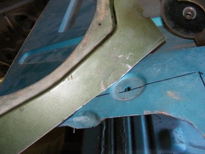

I had decided to mount the new section in the same orientation as the right, just moved over 3'. There is a section that was recessed that needed to be flattened out to do this.

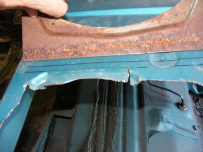

This is why I needed to mount it like this. The section where it was spot welded to the body is rusty. The new section needed to be trimmed down past that rust. That left the section near the recess for the defogger a little short though. Its not real clear, but the recess was bent up and flattened with a hammer and dolly to give me another 1/2" of metal to work with.

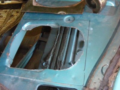

I trimmed the hole to its final size, trimming back where the old section was spot welded to the body... Well.. kinda spot welded... The guy on the line musta had a bad day and the spot welds are right on the edge.

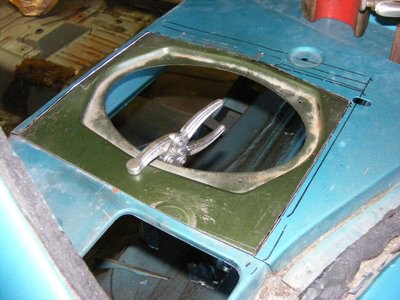

With everything cut, the section sits down flush with a very small gap to butt weld.
The edge will get a few holes drilled in it and then plug welded to the body. The rest will be MIG welded together when I get back to it.
