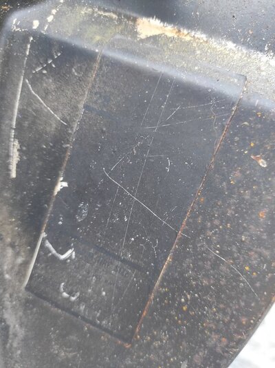

Does the "new" VIN tag not look like proper Chrysler vin tag on the dash? (For a 1969 car).
I'm confused by the situation, but my guess is you will need to give your authorities the paperwork and US registration that matches the current tag.
I hope the attached VIN tag matches that.
Yeah, looks like an original 69 roadrunner vin tag. RM21H9Axxxxxx. Rivets look correct also, black rosette ones with 6 points. I'll get you a pic when I'm at the car.
Edit: added pics. The best I could get, windshield is really foggy. The service record sticker is kinda cool too. The other sticker with tire pressure etc. is covered under that stupid sprayed on black paint that's on the door trims and the engine bay for some reason.
I won't have any issues getting the Greek "historic car" plates and registration with that vin it got in '79. I know that for sure. My only worry is that it would hurt the legitimacy of the car. Either we like it or not, it is a collectible now
