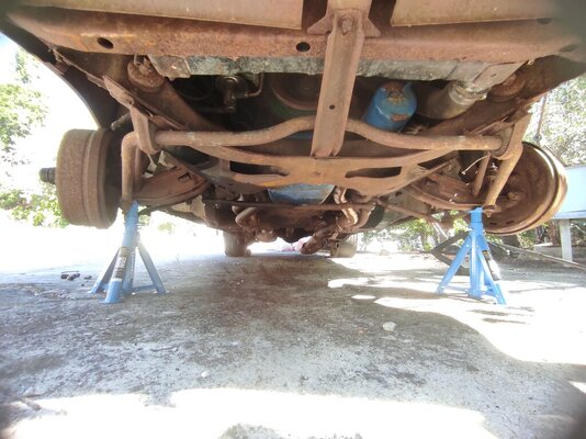

Get it structurally sound at a shop and just drive it as is. Simple enough to get the car going on your own. Suspension is no big deal to do.
when you have the lca off, look at the weld around the tube. Those break and cause issues. Time to get it welded up is right then and there.
Your jackstands look plenty sturdy to me.

I revisited the jack stand pictures and I tend to agree with the Get Stronger Jack Stands vote.
Not that they are horrible if that's the best available.
Back when I was young, I heard those type called "suicide stands" buy a funny guy.
He had a dry sense of humor.
The only ones I'll use are 6 and 12 ton.
12 ton when I want to get the car up high for added footprint and beef.
But I'm not so paranoid that I need anything other than a good ratcheting type.
The pins aren't the problem, it's the leg design from what I can tell in the picture.
Pins are even recommended by some over ratched.
IDK, those legs just looks flimsy.
(Spread um.)

8x8 wood timbers with wood screws to hold them together. 4 on one side and 4 on the other. It is a method that requires to move them now and then when doing frame rails. Everyone told me my car would taco and doors would not fit. Not true. A good floor jack is needed to pick up your car. Had those type of jack stands to help hold like the rear end and stable the rear of the motor. So many guys have been hurt with cement blocks and under rated stands.
quikbird
3,233
1,024
Sarasota, florida
I won’t use less than 6 ton jacks with solid bases. Just don’t feel comfortable with less. And shake the hell out of the car before get under it also to check
