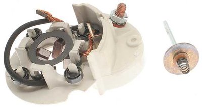

OK, there's only two things that go wrong with a Chrysler gear reduction starter.
First is the starter drive. The starter will spin but not turn the engine over. Napa doesn't list one, but I just looked on ebay and there's a couple on there for $5.
Second, and probably more common, is the solenoid contact. The starter will click, but not turn over. Usually it takes a while for this to get bad enough to where you can't start the car, but if it starts to go, it will go eventually. You used to be able to buy just the contact, but NAPA #STK16 is the brush holder with new brushes and contacts.
Looks like this:
Turn it over and you'll see the contacts. The large one is the one that errodes over time.
That contact is the backside of the starter battery connection. It wears in a half moon shape. I have taken that bolt out and turned it 180 degrees on a couple of my old beaters rather then buy the whole repair package. That worked just fine.
That exact fix was the VERY FIRST THING that my dad ever taught me after I bought my first 340 Duster. That brings back some good, old memories from 1978... :thumbsup:
