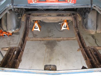

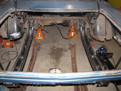

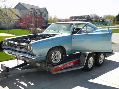

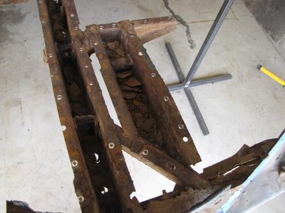

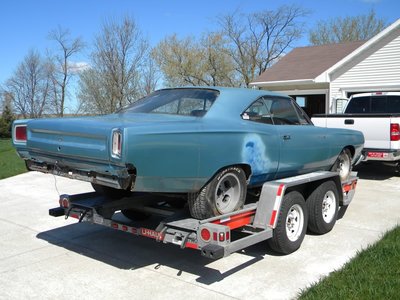

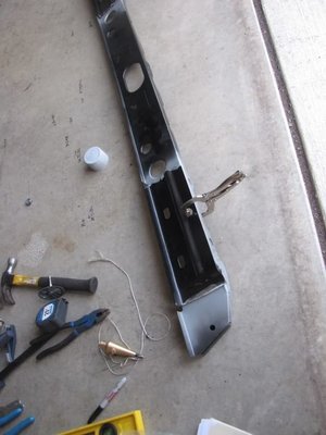

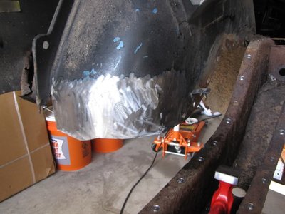

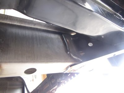

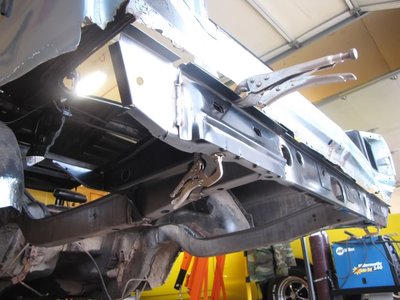

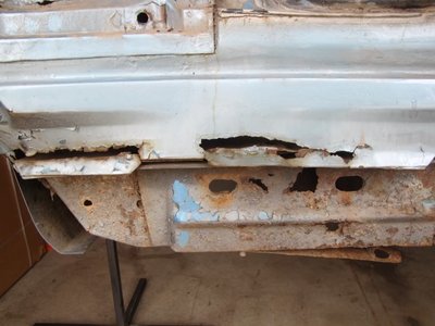

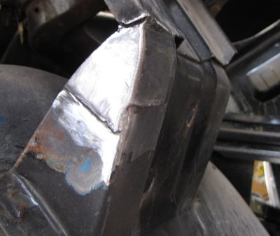

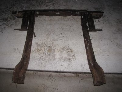

Joined up a bit ago and I'm finally getting a chance to head on over here. I picked up this 69' Roadrunner over in Minnesota about 3 weeks ago. The car has a 440 in it w/727. Its a bucket seat console car with originally a vinyl top, b-5 blue, and black hood stipes. I couldn't tell you what exact color it is now and obviously the vinyl is long gone. With this being a northern car, the rear frame, crossmember, shackle mounts, and front floor pans are/were pretty rotten and I am in the process of replacing right now. She needs a bit of work but I keep plugging away in between my 70-80 hour work weeks. I recognize some folks here from FBBO, good to see you gents! And hello to everyone else, glad to be here!

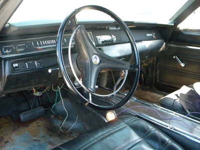

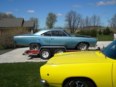

Thanks for the warm welcome guys....and yes Jim, it does have factory black interior. Also nice to see a fellow wisconsin guy here as well 3birds. I'm sure I'll be asking bunches of questions to all of you as time goes by and I progress further on the RR if you don't mind. From the pic's i'm sure you can brightly see I have a 68' Coronet 500 vert. as well. What can I say, i'm a B-Body junky! Had mopars since I was 16 and i'm sure looking forward to this new chapter in my book.

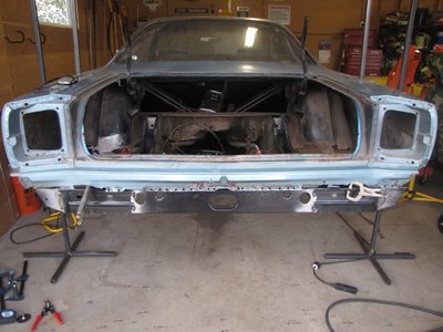

Welcome from Southern Indiana. Are you going to use the AMD one piece trunk pan? If so, you might want to wait until you get it in to weld up that rear panel. Great pics. Keep us posted on your progress.

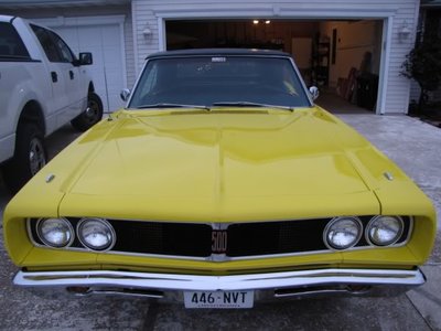

I wasn't sure if I should post any pic's of the Coronet, but if you guys say its ok..alrighty then.

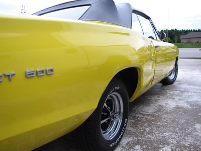

Little story behind it...I've had the car since I was 17 when I traded a 72 roadrunner for it. I had completed most of the restoration on the roadrunner and the coronet was a heap, but I just had to have it. Took about 2 years of blood sweat and tears to bring her back. After a tedious treasure hunt, it's got the original 383 w/727, split bench, power brakes, power steering, power top, power windows all from the factory and is one of 2000 coronet 500 verts built in 68'. I had no clue about all the numbers and options back then, just wanted a late 60's mopar and it was a vert to top it off.
This car use to share the same cancer and more as the roadrunner does now (coronet made in St. Louis, sold in Canada), so having it next to me in the garage while working on the bird gives me a bit of motivation when I get a bit overwelmed.

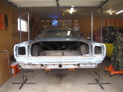

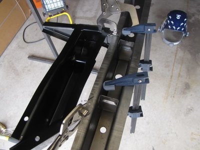

Thanks again guys..I appeciate the imput on the trunk pan. I actually have the two piece floor pan for it. My plan for weld up is, fit/jig in the rear crossmember to the frame rails/shackle mounts. Slide in jig/fit up the trunk pan, remove and replace the rear fill panel( leaving the tail light buckets in for proper alignment), then weld in the fill panel and move onto replacing the tail light buckets. In between I will weld the lip from the trunk pan to the lip on the fill panel, then weld up the rear crossmember to the bottom of the trunk pan lip, and then weld in the rest of the trunk pan. Easy enough right? :eek:
