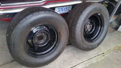

Well, went ahead against much deliberation and purchased some 15/8s for the rear on 275/60R15 and 15/7s for the front on 235/60R15. The front tires came in already and look as though they have the tread and side wall but hard to tell until I have them on and mounted. I’ll send a picture update when she’s ready.

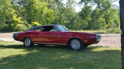

I am running the same wheel and tire combo, but with 15 x 8's on the front also. Did it more so that I can swap any wheel into any tub at any time. I think its a pretty good combo.

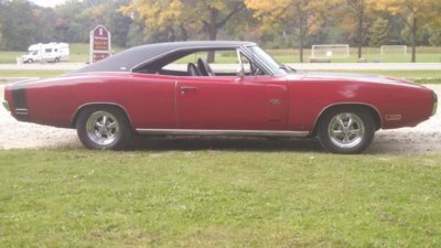

I didn't want the jacked up look on any of my cars. I have four different sets of 15"x8" rear wheels with 295/50/15 tires. Rallye's, Cragar's, Steelies and Road wheels/Magnum 500's (no pictures ). I like the wider look and no big rake with the stance.

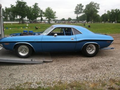

I do the opposite to eliminate too much rake. I have 315/60/15 drag radials on my Challenger (30" tall tire) and I run -1" under leaf springs and 1" lower blocks to keep it lower.
