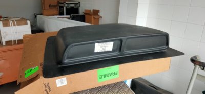

long search, but I found a 5" high sixpack-style scoop (as a seperate pice to the hood), at year one of all places.
https://www.yearone.com/Product/Chrysler-B-Body/GGS031 (1000-10) - 1969-1969#prettyPhoto

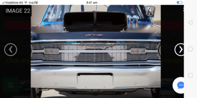

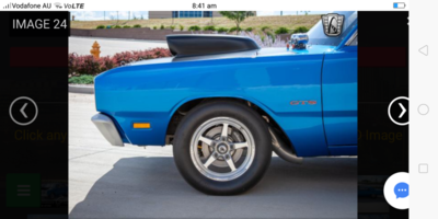

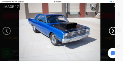

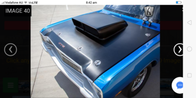

the edelbrock performer dual plane im currently running is 4 inches high, + 1" spacer puts me at 5". The tunnel ram is about 9" high. If my mathematics is correct, the tunnel ram might just fit in underneath this scoop. here is a dart with a similar approach that i managed to find some pics of. Straight outta hotwheels if you ask me!

I was also 50/50 - until I found those photos of the dart. Now I just need to find someone to help me fab it into the hood.
Take note of the 4 hood pins across the front though - Ive got a feeling the hood was not real sturdy, especially after they cut a big ol' hole in the middle of it.

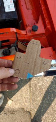

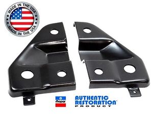

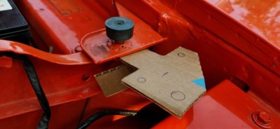

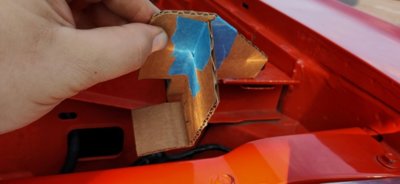

Found some repro bolt on brackets made for a 70 Challenger, that look like an extension of the hood support pad. Now mocking up a fab for a bracket to bolt it to. On the drivers side, theres a factory hole punched in the radiator support that I will bolt to. Considering putting a matching hole on the passenger side so the brackets can be symmetrical. Didnt really wanna put any new holes, but it seems like the best solution for a clean job. It will also mean the brackets are removable at any time to put the factory hood back on. ,s-l300.jpg thumbnail_IMG20200130171744.jpg thumbnail_IMG20200130171753.jpg thumbnail_IMG20200130171813.jpg

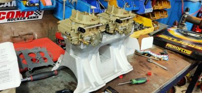

Not mounted yet, just putting in bigger 1/2" fuel lines and an electric pump to feed it. Also a regulator just before the carbies to make sure pressure is the same through both 4 barrels.
The car is also getting a hemi 4-speed (thank you Coyote!), gearvendors overdrive, and dana 60 - no more unwanted loud noises at the track!
Unfortunately though, when we took the heads off, found a small crack in a really unpleasant spot, so decided to put the "fix it" money towards a set of better heads. And we all know how that story goes....
