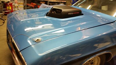

Good Golly Miss Mollie look at that. No hiding that one under the hood. LOL. Looking good. Make the street rumble. :thumbsup2::thumbsup2::thumbsup2:

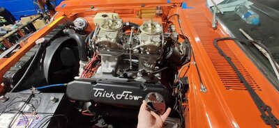

Looks pretty damn sweet. Mine is now all painted. Hood is now all final adjusted since these pictures.

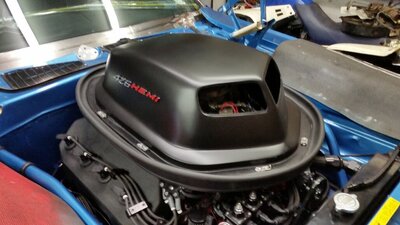

Yep that is a beast. Your on the rite track. Will the hood have a air grabber on it. Or just have the stack's coming through it.

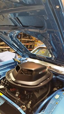

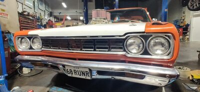

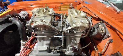

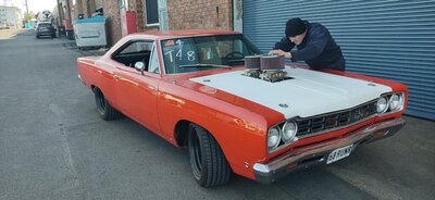

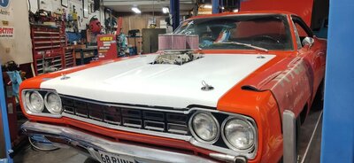

Stuck the sixpack-style scoop on last night, and the tunnel ram might just fit - with no air cleaners. Im cutting out the front holes today on the scoop to have a proper look and see if its worth salvaging. If not, Im completly fine with the balls-out approach.

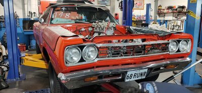

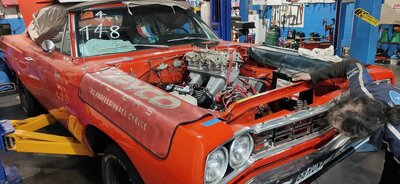

Threw on some el cheapo mufflers temporarily so I wont have to tow it home before modifying hte exhaust. X-pipe was situated RIGHT where the new Gearvendors sits, so It'll have to be moved back.

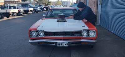

Havent had a chance to stretch the legs yet, temporary mufflers are only taking about 1% of the noise off, so I think I want to wait till that exhaust is on to try not to get any little yellow stickers. Should have it done in a couple days, then Ill hit the highway.

How is the gear vendor ?
Gear Vendor is mint!
I'm running 4:10's in the new Dana 60, with 275/60R15's.
Before GV - 60 mph 3000rpm
With Gv 60mph 2200rpm
Cross country drives should be no problem. Will be interesting to see what kind of mileage I get compared to the old 4 barrel with no OD.
I'm not holding my breath for any miracles, but if it's at all better than it was, I'll take that as a win.
