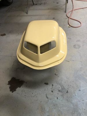

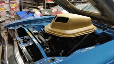

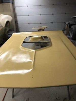

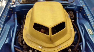

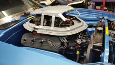

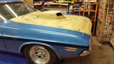

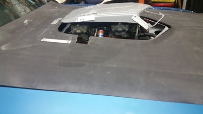

Not on my Road Runner but I run a tunnel ram with two 1050 Dominators on my Hemi on my Challenger. I stretched the hood opening 3", stretched the scoop and base 3" to match, raised the scoop 4-1/2" and enlarged the nostril openings 2-1/2" taller. Project super shaker. Painting it now.

:lol: But you know I like it something different. It look's good and if it function's what the hell. Have seen home made air grabber's in the 60-70 that looked throwed together. With out much thought in appearance. Good work. :thumbsup2:

Thanks. Painting the hood B5 to match the car and the scoop and base will be satin black. I made tubular mounts that the base clips and locks on to then the scoop clips and locks to the base. It can all go on and back off in less than 20 seconds for serving in between rounds. Try that with a stock shaker. Lol. Had some 2X decals made also.

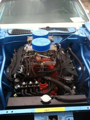

Ordered my new heads with too soft a spring, luckily found some appropriate Manley springs local, came in overnight. Painfully expensive mistake that was. Read the max lift spec but not he spring seat pressure. Wont be making that mistake again.
RKNRLR
Mar 27, 2017
705
653
Sydney, Australia

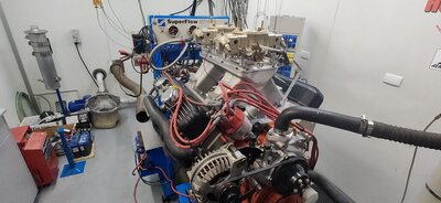

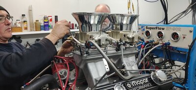

Not as much of a pig down low as I expected. Twin 4''s from APD run real nice. Went with 2 x 650's, look nice with the gold finish.
