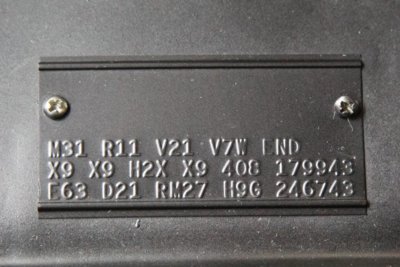

OK, so I was having some fun today looking at Fender Tags of 69 Runners that are for Sale. Yes, for me it's fun. Searching for Rag Tops and came across this one. I was confused by the Fender Tag and am suspicious about what I see here. Of course there is a thread all ready here that addresses the V21 Code so I'm asking the question if anyone else thinks this tag might be bogus. X9 is the paint code for "black" so why would there be a V21 code for a black stripe on the hood? Plus this Tag, hmmmm, looks very pristine for something that near 50 years old? Plus St Louis Tags almost always had a random stamping of a letter on them, at least mine does and that's what I've read. This looks as if stamped yesterday. 736_p24_l[1].jpg

Fake! Actually a black car with the V21 looks pretty good!

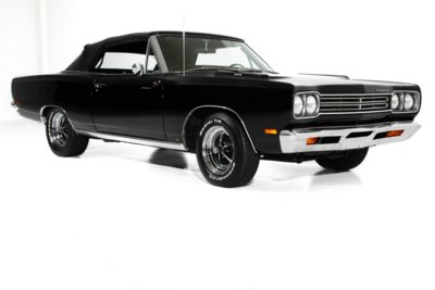

That's what I thought. The car itself doesn't seem to have black hood stripes though, I could not tell from the photo, but that's interesting they were made apparently that way. The car is missing the V7W as it sits also. Which I think would look cool, but it's easily added. I did with mine. It's just a 1/4 inch painted stripe down the side.

It's a really nice looking car and the Vin is correct for a Convertible. Just this fender tag, makes you wonder about the whole car. If they just painted it to what they thought would sell or what, even if it's an authentic car. They seem to have a lot of Black Cars in their inventory, like its a theme736_p5_l[1].jpg
