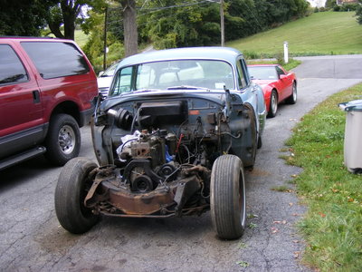

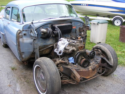

Finally got one of my sons here long enough to pick the "dog house" off the front. This came off pretty easy, about a dozen bolts and the front was lose. This will make removal of the engine and trans as a unit much easier. One thing I discovered was the flathead weighs a lot more then a V-8. Hoisting the assembly up high enough to clear the radiator yoke was imtimidating me a bit. This will make it much easier.

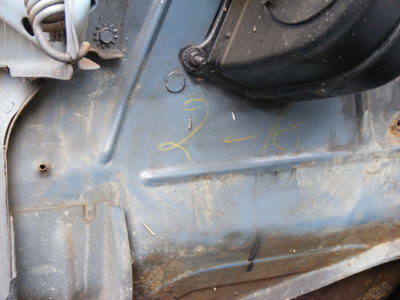

In case you thought only sixties cars got inspection marks.
22,148
2,358
The old markings are cool! They sure put allot of steel in those old cars :yesnod:
