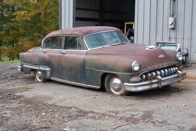

The front floor had a couple small areas of rust that needed to be fixed and typically, the inner and outer rocker panels needs a little "love". I was going to do that myself, but decided that laying on my back, welding upside down under the car would probably not be a lot of fun, so I decided to farm it out to a Hot Rod fabricator I met. He's got a couple interesting projects going, including building a custom 53 Desoto for himself.
This car will get the 50's custom treatment. Packard tail lights, peaked fenders, lowered etc. Should be cool.

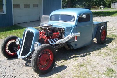

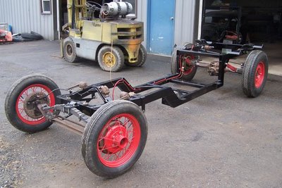

He started with a junk Ford truck cab, chopped the top and built this frame. Its got a 454 Chevy with Caddy valve covers that gave it a 50's look. I'm not into "rat rods", but this thing looked like it was a blast to drive.

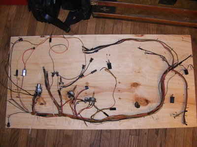

Doing a little more wiring work. I pulled the dash harness before the car went to the shop. No fun laying on my back doing this, so I may pull the dash for the installation. I made up this board to keep the wiring straight while I replace the wires, one at a time. All the wires are held in form by fininshing nails driven into the plywood.

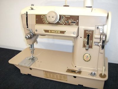

Bought this bad boy on Ebay an hour later....
1958 Singer mod#401a. To paraphrase Danny Vermin in the movie Johnny Dangerously. "This thing will sew through schools"
