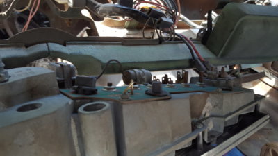

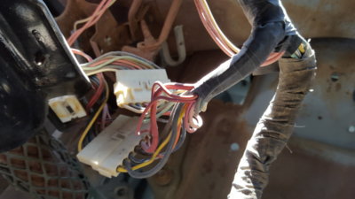

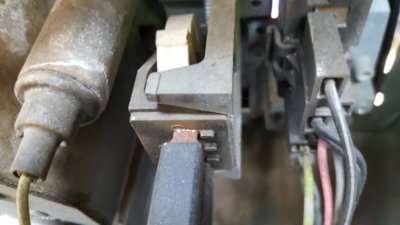

I just do not trust the wire harness I have I am not making my Roadrunner 100% factory I want a Dailey driver

Yes, those can be redone better than new. Comb the wires out and untwist and loop the cables, no 90 degree corners, retain tape that still sticks lol. As long as the wire insulation is supple/flexible. After Navy service worked at a place that made sonobuoys for the Navy P3 Orion’s. Learned how to build aircraft harness wiring- it’s at another level for certain. Any soldering and you had to still be able to see the individual wire strands.
Don’t forget fuel gauges/senders work through the grounded side of the grid only. Don’t want 12VDC positive sitting in fuel tank....
Too, was in the Navy and Army, so it doesn’t make any difference who wins the football games to me. Did retire Army(R) though. Incase any ambiguity with prior posts. Neighbor asked me once; I was wearing ships ball cap “thought you were in the Army”. A real rocket scientist.
Forgot, the worst part of the harnesses is the main plug that connects through fire wall; can get corroded and intermittent continuity you can not locate. They do get subjective to weathering also.
