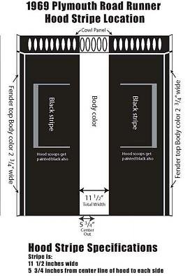

I cannot find anything that states which car get the stripes or not. Big John would know, I believe all 69 Roadrunners had hood strips but I could be wrong. I attached the hood stripe specifications.

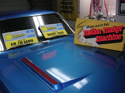

The hood stripes were an option of a touch over $18. and change. The guy that ordered my hemi car new didn't opt for them. :yesnod:
