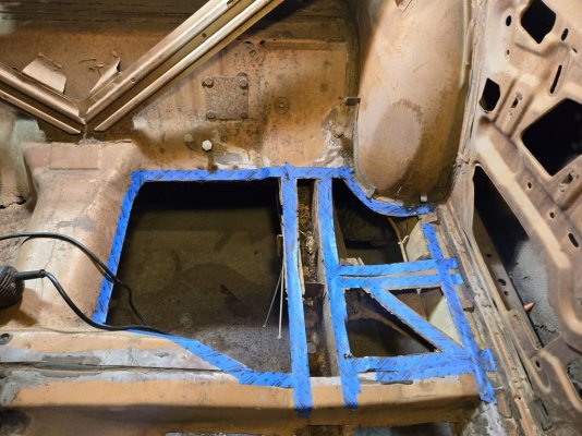

Driver's Side Rear Back Seat Foot Pan: taped out my cut lines so I make nice straight cuts and avoid structural frame rails.

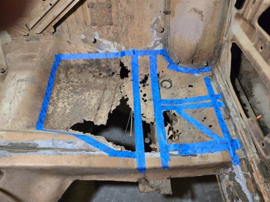

Driver's Side Rear Back Seat Floor Pan: carefully removed. I decided to keep the lateral cross member temporarily because I see still have to move the car around the shop and trailer the car to get it professionally dipped or media blasted (still deciding on which path to take) and want as much structural integrity in the car as possible.

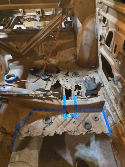

Driver's Side Rear Back Seat Floor Pan: Taped up and ready to be removed.

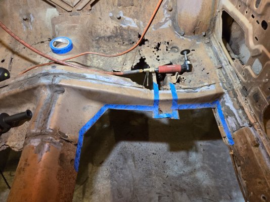

Driver's Side Rear Back Seat Floor Pan: Removed. I cleaned the frame rails and Removed about one inch of solidified dirt and debris that accumulated at the bottom of the frame rails.
I will carefully expose the spot welds, remove the rotten sheet metal from the frame rails, remove the rust from the top and inner frame rails, inspect the inner and outer frame rails, and temporarily encapsulate the exposed metal with rattle can primer.

Instead of using temporary rattle can primer and taping, you can save yourself a lot of time and effort by using a weld through primer.
IMO if you are going to have it dipped or sandblasted there is no need for any primer as there will very little if any surface rust forming and it will be taken off when you dip or blast anyway - save your money.
