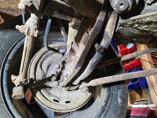

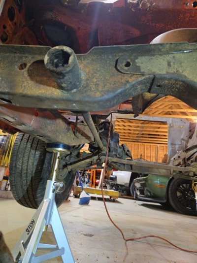

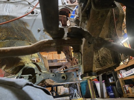

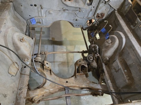

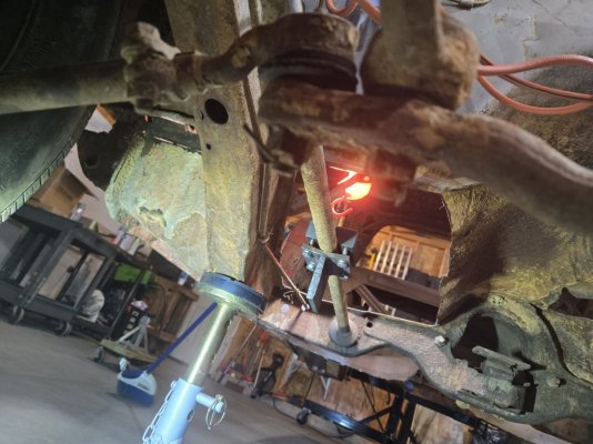

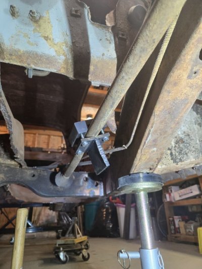

Ok...so: Off with the front suspension!
Torsion bars have to be "gently removed" from their mounting location....
Thank God for the 1/2 Pneumatic impact!! The 3/4" Bolts were seized! I carefully worked the bolt turn by turn and PB Blasted until they properly rotated.
I cleaned and carefully removed the torsion bar retaining clips.
Then used my mancini racing torsion bars removal tool and beat the ever-loving snot out of the tool until the Driver's side torsion bar finally gave up and came out.
Success! The Driver's side torsion bar is out and on to the Passenger's side....
Ya...then I snapped one of the 7/16" grade 6 Bolts on the torsion bar puller...and I called it quits for the evening.
Gotta go to the hardware store and scoop up some grade 8's...
