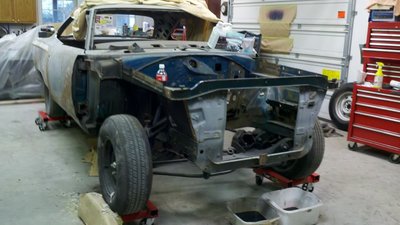

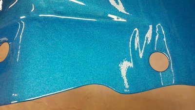

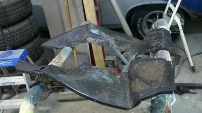

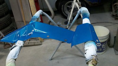

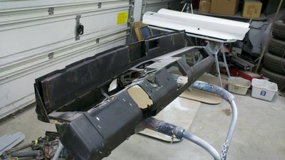

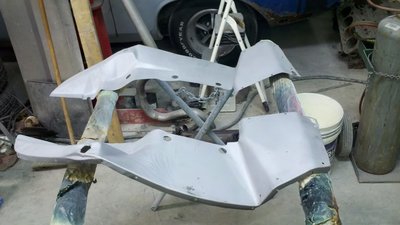

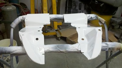

A little color testing going on here. I can not get the camera to capture the true color with this LL1..........
13,678
833
Great color. Would look good on your Chally siting there waiting for some attention... :D
22,148
2,358
Considering those are supposed to be satin black I do like the color :acme: :jester:
Hoosier Bird
Oct 4, 2008
3,495
Hope, Indiana
Believe it or not I was going to ask you what color these should be.........
22,148
2,358
I got your back Gary :jester:

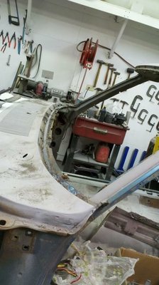

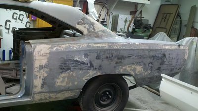

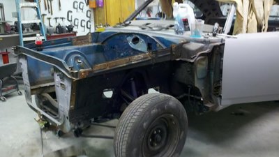

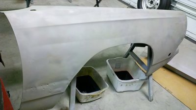

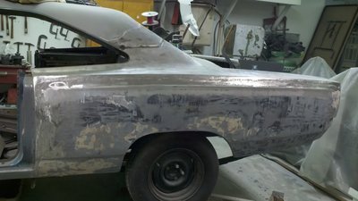

Looks like it's coming along nicely Gary! Is there any rust to repair or is it just the dents and dings that you have to do?
Hoosier Bird
Oct 4, 2008
3,495
Hope, Indiana

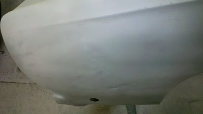

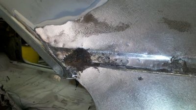

There is some rust here and there. More poor bodywork than anything. Whoever put the quarters on didn't know what they were doing and I've found lots of surface rust under the primer. I've also found bondo covering rust..... :brickwall:

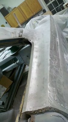

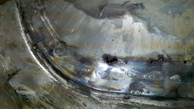

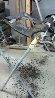

This is exactly why you ALWAYS, ALWAYS, ALWAYS get the lead out of your factory lead joints. These joints look great until I melted the lead out.
great job Gary!
becareful or you mlght flnd a yellow runner at your place ln need of your touch......
724
X2...I think that is where the expression "Get the lead out" came from. :lol:
