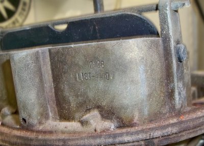

Here's the dirt... 3 pics of broadcast sheet, and one of carb. I can get a fender tag shot too if needed but I'll need another day for that, no idea on decoding them other than basic options (would be cool to have all that info on reference section)
Holley carb 2428 LIST 4440

Well the carb is right for a 68-69 383 mopar with any trans........... :thumbsup: I don't have a clue on decoding the build sheet but I'm sure someone will.
22,275
2,524
My broadcast decode book shows you have a low perf auto trans and engine and they did have a holley on that engine which was a 4440 which you have and the date on your carb is the 242 day of 1968 which would be about right also. I'm trying to decode the actual carb code which is tricky Ill keep working on it.

This is out of Galen's book.... Hopefully you can read it. At the end, the letters signify models with "R" being Belvedere, "W" Coronet, etc. Note the 575 CFM rating. This is getting very interesting!
The "594" designates an 8 3/4 3:55 Sure Grip ... The "D56" could be either a Dana or 8 3/4.... :huh:
Edit: To clarify, this was taken from the Holley Carb section of Galens parts app book.

Axle package cars with A/C are rare, I've seen only a small handful over the years...all were of the 3:55/3:54 variety. I should have read Galens book closer, it does appear that a Holley 4 bbl was used in 69! The only stipulation I see is that it had to be an automatic. I would love to have more info, such as how many made it out the gates, what criteria was used such as A/C, cruise control, etc. I think it's safe to say that you have a fairly rare car there! Thanks for sharing! You may want to contact Galen and see what he has to say about production numbers of this configuration... of course, he'll probably charge you, and it may take a while.... good stuff nonetheless! :thumbsup:
