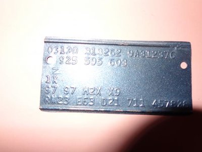

i'm guessing this car was a very rare special order 99 99 ralley green car , from the color on the core support and the rear package tray , it sure looked like it
69383RR
Jan 28, 2012
447
up state vermont
I have that invoice sheet that was under the back seat , would the color code be on that ?
