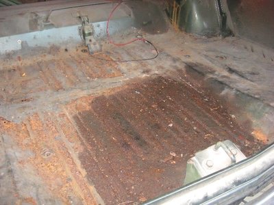

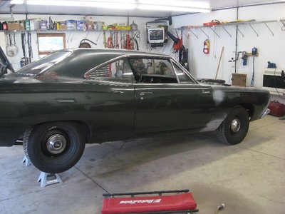

Thanks to my Uncle retiring last month, work has now started on the complete re-birth of my 'Bird. The pace is slow, and there hasn't been much progress. It'll halt here after Wednesday as my uncle is leaving for Ireland for the rest of the month. But, at least it's out of my garage now. I'll update this thread as things progress, but again things will be slow.
Trunk floor:

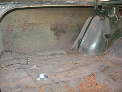

More.
Steering wheel off.
That's all for now. Maybe today or tomorrow I'll have more. This is where we're at right now.

That's not so slow. Isn't rust fun, just keep cutting back there is good metal somewhere :thumbsup:

Thanks guys. Yeah, it does feel good to finally start. I hope we're on the worst now, although I'm afraid to find the rust once we pull the back glass.
The trunk stuff is worse than we thought. The wheel well housings are gone on the bottom, and the entire back section of the trunk about fell out once we started cutting. This will require a lot of extra fabrication. Today we made a patch for the right wheel well, and the left is almost done. Tomorrow I'll grind down the spot welds on the frame and prep everything for a nice coating of POR-15. We had hoped to have the trunk floor in by Wednesday, but that will now have to wait until August.

I'm thinking this girl will be several years in the making too. Nothing else really done either yesterday or today. Well, I did get another master cylinder on today, so I guess that's something.
Nothing more until August though. Actually, it might be nice to take a few weeks off after a solid 5 days of working on it.
