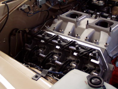

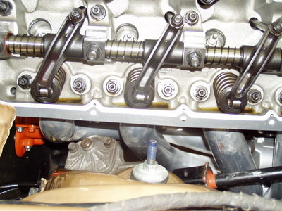

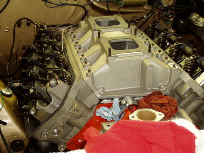

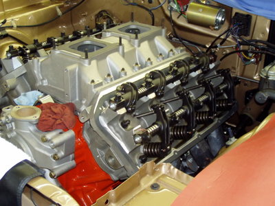

Well we finally got the engine in today. I had a lot of good help from my buddies and it took all them as it turns out. The headers were a bitch as expected. I hope I have enough high temp rtv on them as I don't want to repeat this anytime soon. All looks good except I can't get the clutch dust pan on because the headers are in the way and I'll have to cut some of the threaded rod from the shock off to clear the valve cover. Also it looks like I may not have a heater but we will see about that. I will try to post a few pics below.

That looks great :thumbsup: sounds like pretty minor stuff thats left other than the heater :worship:
Jack
why didnt you use just header gaskets.....thats all i use and they havent leaked......as for the heater...it will work....valve covers will clear with hoses off.....looking great.....what roller rockers are they??....is that intake just a mock-up.....i dont see any valley gasket.....dont use the foam valley gasket....black atv works best

Looking good.
Please stick rags in the intake for me, it makes me nervous just looking at the pictures. :toetap:
I was wondering about that - I mean the big valve cover engines were available from the factory - and I've never heard anything about all Hemicars being heater delete...
Take somecarguys advise and throw some rags or block-off plates on that intake...

Definately cover it up, cause if you get a guy that likes that as well as me and he gets close he may blow a nut in it.......... :lmao:

Don't worry, I always keep the intake manifold covered. I only pulled the rags to take the pictures.
George, I think the valley cover is cast aluminum as far as I can tell. I haven't been inside there yet. I have used the Permatex Copper RTV on about three cars now and I love it. I kept blowing header gaskets on one car and thought that that was just how gaskets behaved but it turned out to be an bad flange surface. Still I have used RTV, usually with gaskets and it has always worked well.

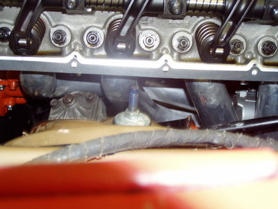

The pictures look like the heater hoses will route but when the valve covers are on, there is no more that 1/2" clearance. I will take a picture next time I am out there.
I think I have to pull the right side header to get the clutch dust pan on. If I do I will have to remove the rtv since it's cured now and I will probably use a gasket on that side. I pray I never have to do the driver side again. By the way if anyone has use for this information I would strongly recommend buying the 2 1/8" tti headers rather than the 2 1/4" ones I bought. That little bit of extra clearance makes a huge difference. I am not sure but I may have to grind a bit off the bellhousing where the dust cover is on the passenger side.
