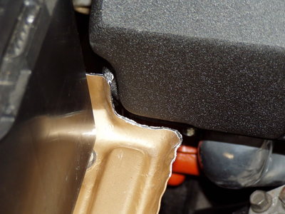

I am making progress. Everything is put together now except for the radiator. I had to grind a bit off of the battery tray to get it to clear those humongous valve covers. That went pretty well. I had visions of installing a rear battery setup for a while. Should have the cooling taken care of this week and will fire it up. Oh boy! I can't wait.

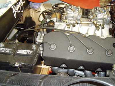

Same thing in the back of my mind. I keep wondering if I torqued all the mains and rod caps.......... :brickwall: I'm sure all will go well on both projects. Yours looks awesome, by the way. Are your valve covers bigger than stock? I sure think your heater will be a no go.........good luck........ :thumbsup:
