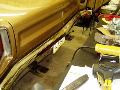

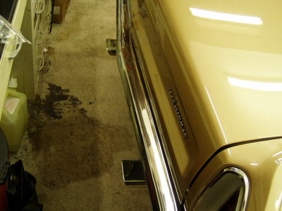

I would like you guys to give me your opinion. The exhaust tips stick out about 2 inches more than the old exhaust did. I can't decide if I like it or not. I can cut a bit more off the exhaust pipes if necessary but it might be a bit trickier with the pipes hanging than when they were in a vise. I have a couple of pics below of the tips installed let me know what you think.

They stick out just a bit too far IMO. Here are what mine look like.
[attachment=0:swi7icde]tips.jpg[/attachment:swi7icde]
To be honest, I think mine extend just a bit too far also, especially the right one. I need to take them off, break out the dremel and do a little trimming to get them inboard about another 1/2 inch or so.
13,678
833
They're out a bit too far Jack...trim those babies back just a little... Everything is looking REALLY good.... :thumbsup:
My car appears to be wearing most of its original exhaust system and the tips don't stick out even as far as John's do in the picture above... :cents:
