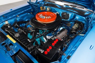

Found a picture of a beautiful '72 RR with a 400 c.i. and manual drum brakes:1972-plymouth-road-runner.jpg.
