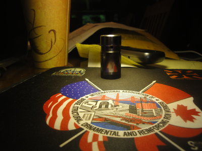

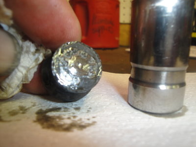

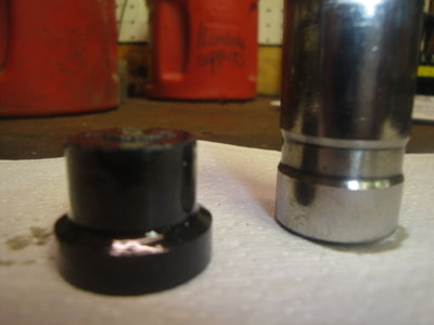

was taking apart the hemi to inspect lifters and after the forth lifter i looked at ....the ceramic bottom fell off......almost went inside block....that would've really sucked......now i have to see if i can replace all....schubeck went out of business[attachment=2:17l98gyt]DSC02875.JPG[/attachment:17l98gyt][attachment=1:17l98gyt]DSC02874.JPG[/attachment:17l98gyt][attachment=0:17l98gyt]DSC02871.JPG[/attachment:17l98gyt]

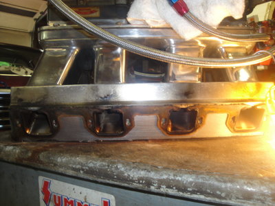

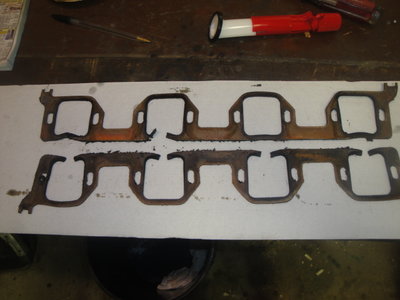

went i pulled the tunnel ram.....6 of the top gasket ports were gone.....was running real bad[attachment=2:2mg2e7uv]DSC02870.JPG[/attachment:2mg2e7uv][attachment=1:2mg2e7uv]DSC02864.JPG[/attachment:2mg2e7uv]

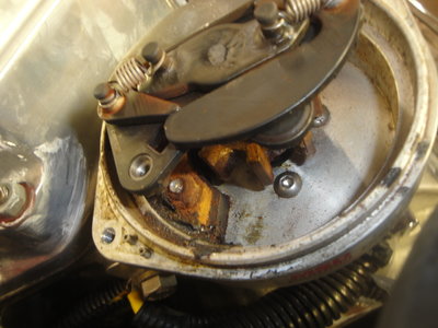

popped the msd cap and it was corroded real bad.....called msd up in texas and said high humidity would do this.....wd-40 or spray clear on it was the answer i got......bought a new module last year and cleaned it up......so i ordered a new one

if that is your idea of a little problem, then i would hate to see a big problem. is there a problem with the surfaces at the right angle with the heads and intake?

i really want to puke.....if i dont find the lifters may have to go with solid uncoated lifters and give the smith brothers a call to make new push rods and also change out my 550 lb seat pressure valve springs to 325lbs or shit can the cam.....go roller/cam/springs.....750 lb seat pressure/new roller lifters
300
glad you caught it before it caused you more trouble.

That sucks George. With the MSD, what in the world is causing that? I thought those caps were vented. Maybe the magnet, voltage and dis-similar metals? I guess when you get the new one a little dielectric grease on the problem areas wouldn't hurt......
ps. these guys are having the same MSD problem. Looks like the new MSD dist. have a yellow zinc coating to stop this.
http://www.msdignition.com/forum/showthread.php?t=16360

when i called him today he said guys are clear coating them or spray a rust inhibitor on it......anyway the new one is on its way.....the wife bought it for me.....lets see if this one is coated

All of my MSD distributors look like they have been living on the botom of the ocean. :lol: No extra cost for that.
As far as the lifters are concerned I would (and I hate to say this) call Comp. They have a lifter with a tiny hole EDMed in the face of the lifter so it gets pressurized oiling from your oil system. Also some of the space age lifter coatings are out there, Crane has a coating called Mikronite.
Or man up and stick an enormous solid roller in there. Yep thats better. :acme:

WOW George, that really sucks and having multiple problems makes it worse. For what you spent on the monster you'd think that they would use better materials. that could take the beating they were designed for.
i have the aluminum indy valley pan.......what i think is going on is......if i use rtv under the pan to block like maybe too much would raise the pan which i have to also rtv above the pan on the rails by the heads which makes contact with the lower part of the tunnel ram......what i am going to do is make a gasket under pan then install tunnel ram and feeler gauge what i need on top of pan......just maybe i could get that figured out and the problem would go away with gaskets and minimal rtv......also my engine builder said to prick punch 2 spots on each port to give it some additional friction to hold it in place

yes thanks.....was lucky and curious since last time i adjusted the valves some of the adjusters where showing less threads then the others.......since the motor was built in 05 i totaled up around 12-14 thousand hard miles :drive:
here is the oiling hole in these lifters ray
[attachment=0:3r580sb8]DSC02876.JPG[/attachment:3r580sb8]
solid rollers just dont hold up ray.....they always had problems failing also
