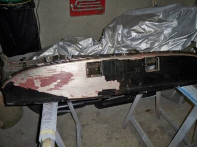

    Here a pic of the dash when we started to work on it, make some progress on it yesterday, will have to post once it will be stripped to bare metal.

    I would prime it black if you are using the original suede paint to make sure it covers!

    looks really good. one thing to watch is where car is supported. this can sometimes result in flex in the body and all those gaps that you have set up so well might change whan put it down on wheels with weight in it. again, looking great

    You sure have put a lot of work in to the runner. Grate job. Oh and now you are famous with you in the pic. LOL.

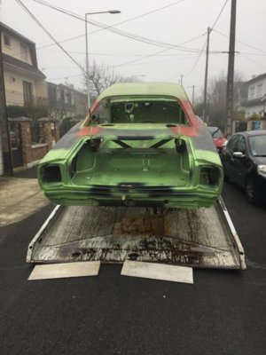

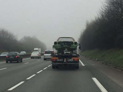

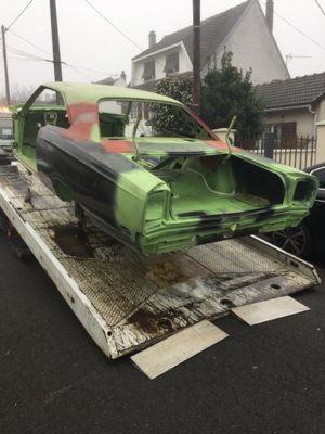

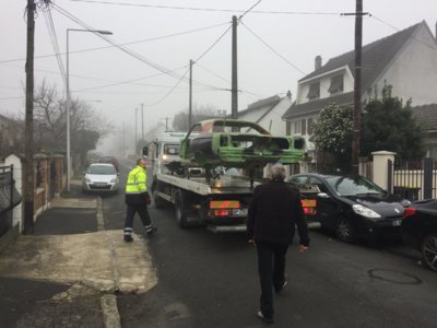

    Quick update with a few pic of the departure of the bird. IMG_6867.JPG IMG_6868.JPG IMG_6869.JPG IMG_6870.JPG
    Two weeks ago on its way to the paint shop :)
