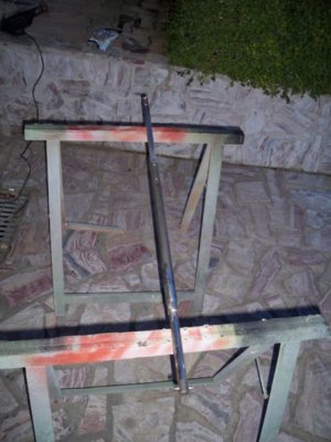

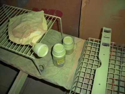

The dash and sun-visors are finally painted.
We pull apart the sun visors painted them and then we lubed the rod that goes inside it because on the passenger side sun visor it is very difficult to move it. So hope it will work better with a bit of lubricant.

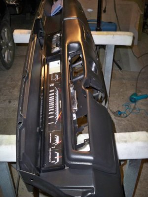

We have started to reassemble the dash frame with the glove box door and the upper pad. Also put the "road runner" badge on with the first decal of the bird. That is a great filling! Especially because when we bought the car like 4 years ago there was no bird decal on the dash. That is a small victory lol.

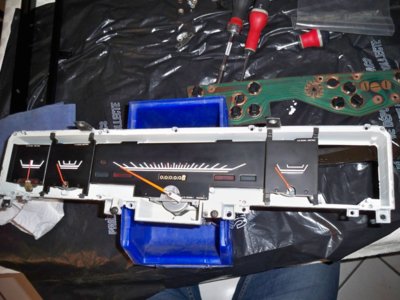

Now we are on the dash cluster and the gauges. We have to paint the needles with some orange color then we'll be able to put everything back together.

Tonight, as in France we have kilometer per hour, we will put some marks on the speedometer gauge for the main speed limit.
Like 30mph 45mph 55mph 70mph and 80mph. Those are the speed limits in france that you may found.

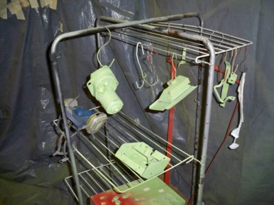

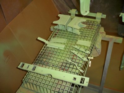

Hello guys! I have to put some pics around here to get you up to speed!
A little bit of thing have been done since the car left for the paint shop.
So here are some pics to show you what ;)

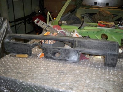

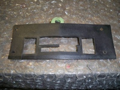

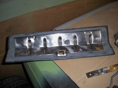

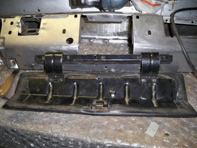

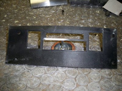

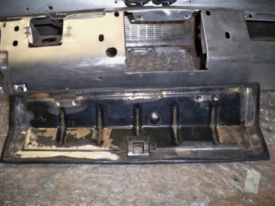

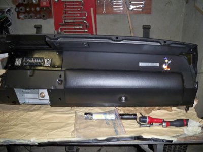

The door of the glove box has been repaired as well as the plastic thing that goes in front of the radio.

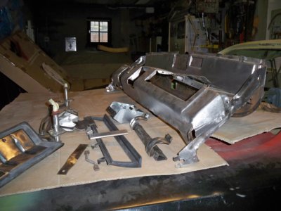

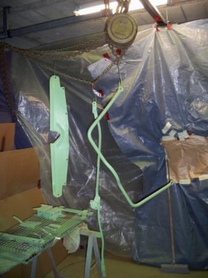

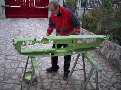

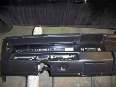

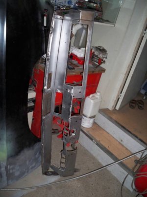

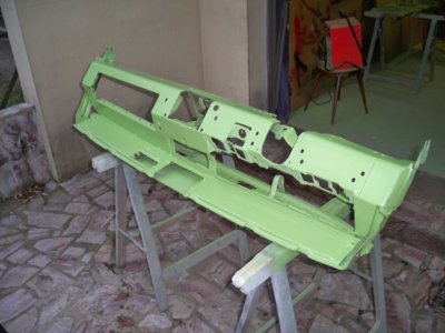

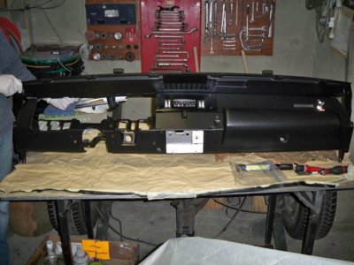

The dash board is finally done. First stripped it to bare metal. Then epoxy primed it before a final wet sanding then apply semi flat black paint.
The top of the dash where the vin goes have been painted flat black to limit the reverberation phenomena on sunny days.

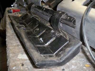

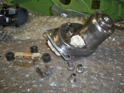

The dash pads have been reworked and some refreshing has been done for other items of the car like the sway bar some additional gauges, the wiper motor and a lot more.
Don't have the pics of all that stuff once it was painted. I do have to take them and then post it here.

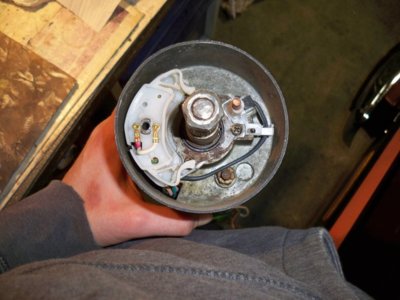

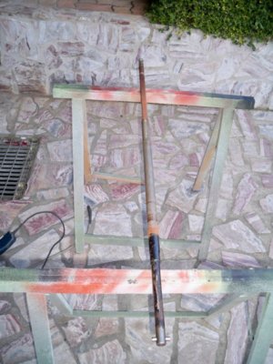

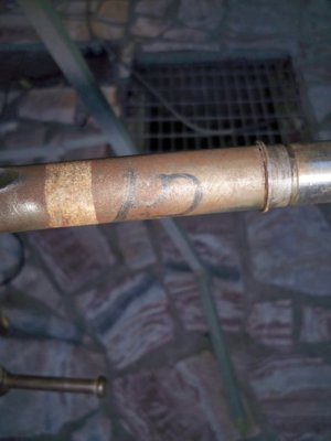

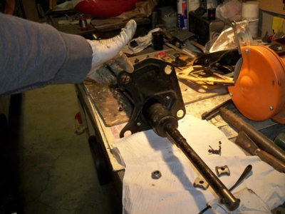

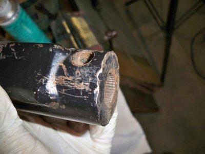

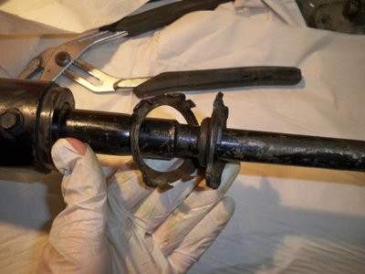

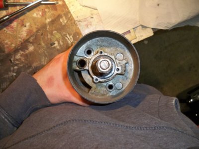

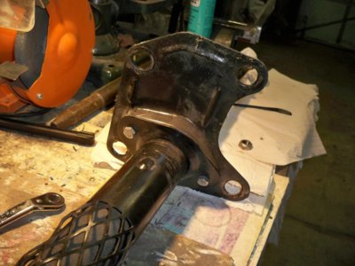

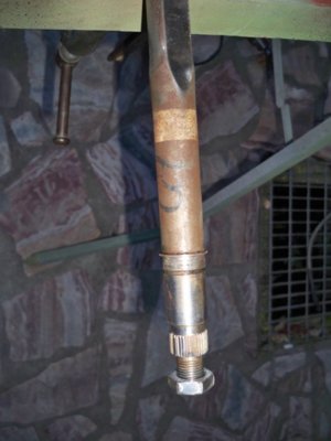

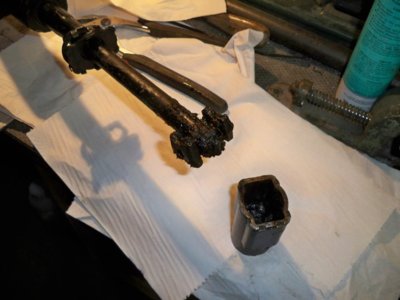

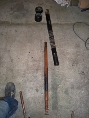

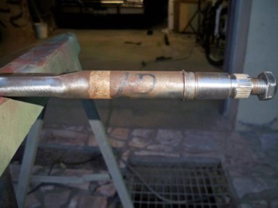

Now lets see the steering column. Last week we ordered the new bearing for it the lower one and the upper shaft bearing too. The lower one was totally worn out! I'm glad I disassembled the steering column because when I started the project I didn't planned to do it, but now, I'm glad I have because of that, and due to the fact that it will be nicer with the new paint on it :P
Once again forgot to take some pics once it was in primer and then painted sorry. I will take some pics!
