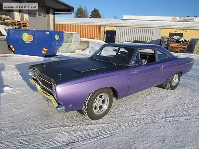

What do you detectives think of these?
What makes the Roadrunner a clone?
Does the GTX look genuine - I noticed that there was no GTX badge on the rear right trunk lid.

pretty much the same advice as the other cars. Look them over in person. Check the frames, floors, all over for signs of rust, or half assed repairs. Between these two, I like the '68, clone or not. good luck.
Thanks guys.
Did they do a 440 RoadRunner in 1968?
Is the rear end trim correct?
In 68 they came both ways with and without trim and the only engines offered in 68 was the base 383 and Hemi option.

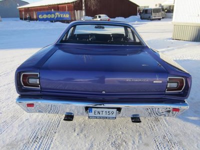

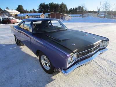

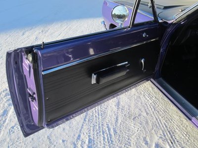

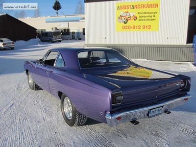

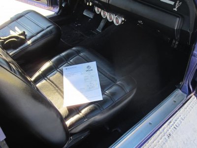

I think this is it!!!!!!!!!!!!!
IMG_2836.jpgIMG_2838.jpgIMG_2841.jpgIMG_2842.jpgIMG_2844.jpgIMG_2846.jpgIMG_2847.jpgIMG_2854.jpgIMG_2860.jpgIMG_2864.jpgsendbinary_med_loggo (1).jpgsendbinary_med_loggo (2).jpgsendbinary_med_loggo (3).jpgsendbinary_med_loggo (4).jpgsendbinary_med_loggo (8).jpgsendbinary_med_loggo.jpg

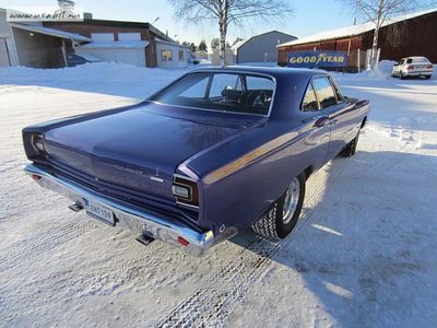

It looks really nice and clean.

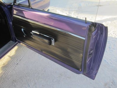

I love the paint even though I don't think it's a 68 colour.
What do you think? 20k GBP
Says its a DANA60 rear end??
Column shift instead of floor. Does it matter? Which is the best position?

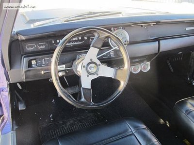

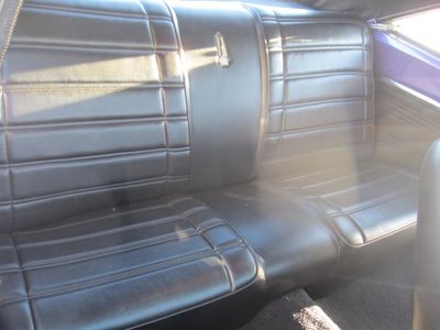

nice looking post car! Correct, that's not a '68 color, it's '70,but if you like it who cares? As far as where the shifter is better, I always hated column shift in a muscle car, but that narrow mindedness cost me a really nice '69 Coronet R/T in high school that ended up in the crusher. Leave it on the column, or gather the console and shifter if you want that.Price seems ok too. Good luck!
69 seats and dash pad.

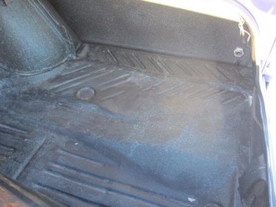

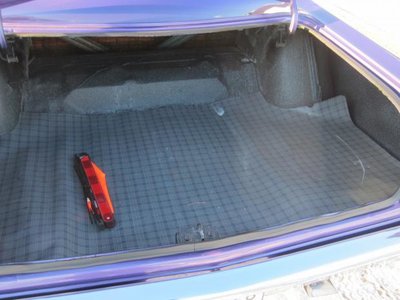

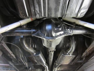

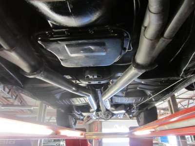

Rear shocks aren't mounted right.... Too close to center at top. I'd take a long look at the upper shock mount.

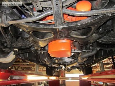

wow! missed that Big. Definitely look hard at that shock mount. Repops are out there, probably busted up from air shocks, shouldn't be a big deal to replace the mount, but look closely like Big said, and check out the trunk floor above the mount, and figure any repair into the price of the car.And while you're under the car, look closely at the frames since they painted everything.

There's a power steering pump but no power brake booster.

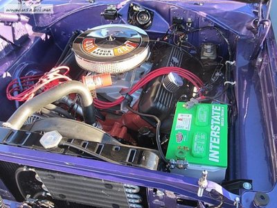

pretty sure I saw a power steering pump. Opinions vary on drum brakes, I've had them for 30+ years with no problem. Drive sensibly, and they are fine.I see they put the hood pins thru the rad support (same moron did that to mine).Sounds great. Check that shock mount over, and everything else we've told you about these cars, and good luck and let us know!
It is a Dana 60 but I bet the exhaust was put in before the shocks were installed.
