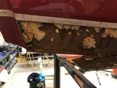

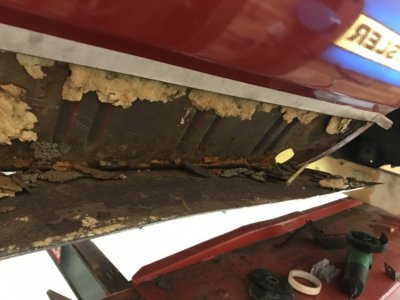

So happy the former owner runs out of pur foam. Car is in the spit and ready for blasting of the bothem

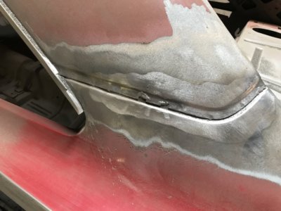

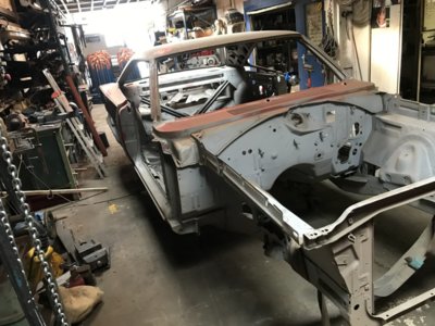

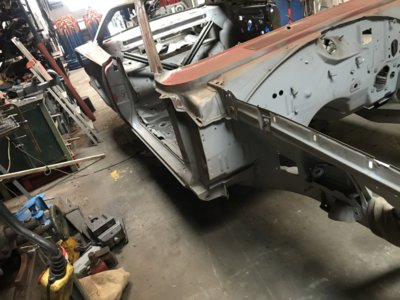

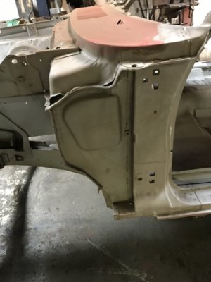

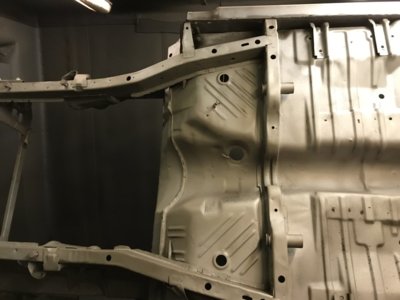

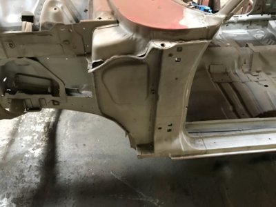

I think i have all the pur removed from the car

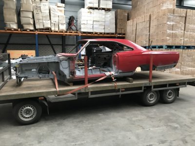

This roadrumner was shipped to the netherlands in 1994
It was a california car (licens plates are still in the car) the pur party was a dutch one anyway sand blasting next weekend keep you guys posted

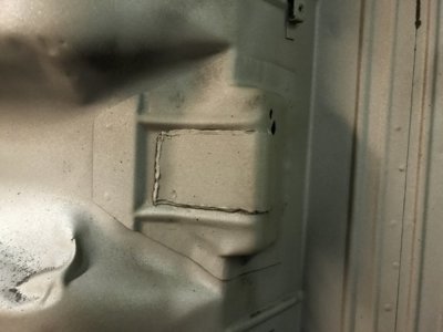

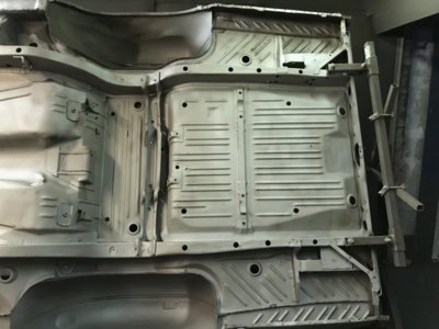

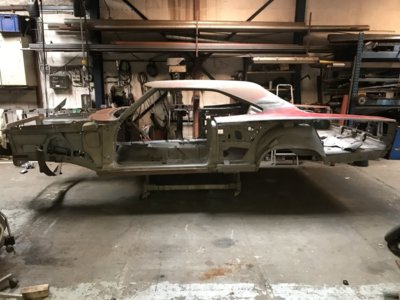

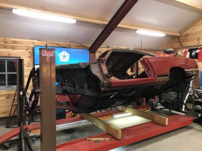

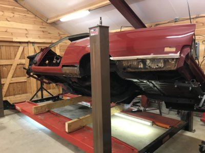

Boy your into it now. Like the car lift. Uther than all that is the rest of the car pretty sound. Some times cant see every thing till you pull all the paint off. Just to think maybe he was trying to seal the drop down area where trash would not get down their. Know if you drop something in to that area it is hard to get it out.

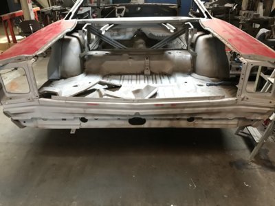

The body looks great! I see the pinion snubber reinforcement plate in that last pic. Finding the broadcast sheet was a real plus!
13,696
860

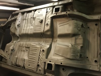

Any reason that you didn't have the rest of the car blasted while you were at it?
oscar holland
Nov 18, 2018
160
127
Blasting of the other parts inhave some bad experiences in the past
Strecing metal and ending up with
A lot of work and a medium result

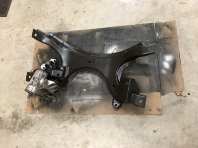

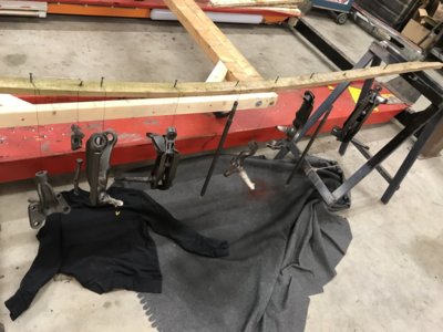

Respray of the front suspension here getting seymore paint in a can means amazon 3 weeks of patience and dubbel up for the price but i like the result

Respray of the front suspension here getting setmore paint in a can means amazon 3 weeks of patience and dubbel up for the price but i like the result
7,846
3,425
It takes that long to get paint oh bummer. Look's good. So it look's like you going with red. After painting the skeleton will start on the K member. Keep up the good work and keep the pic's coming. Russ.
