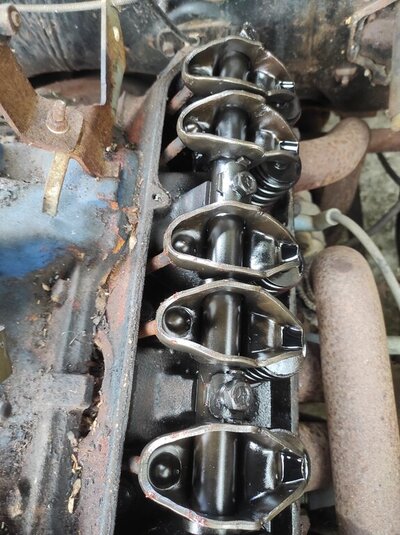

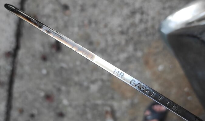

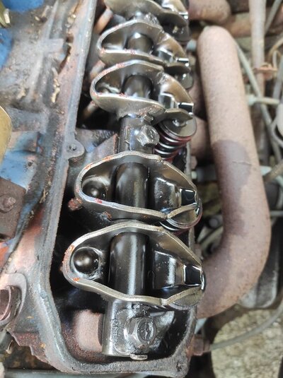

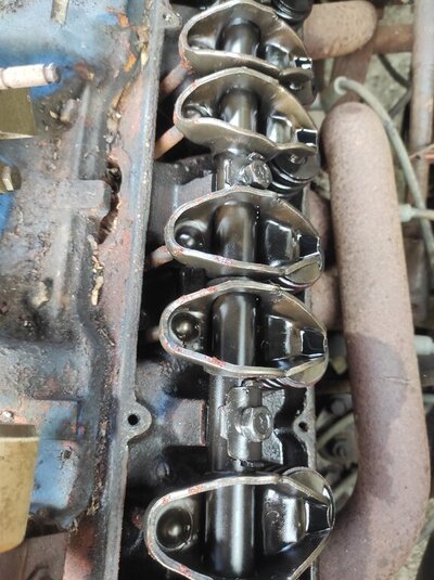

Pulled the valve covers today checked under there and also it is still full of oil. (Aftermarket dipstick?) I thought the engine was seized from decades of not working but that might not be the case after all.
Wow she's clean. I'd change oil, put fresh gas in it and try to start it.

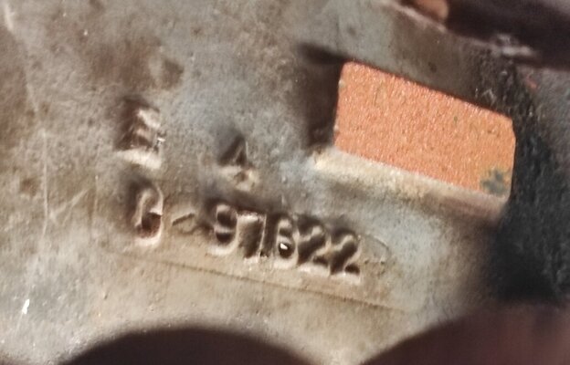

I wanted to make sure it turns by hand first and replace a couple of things like spark plugs, spark plug wires etc. Plus I need to see the casting numbers on the engine to know what and when it's from. They're on the worst possible place. I don't think it's original to the car. Between the turquoise color, the painted engine bay and the revinned dashboard I've been thinking the car might have been raced early in its life and caught fire at a certain point maybe.

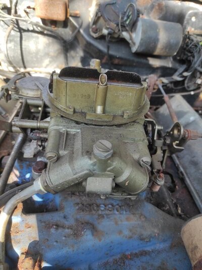

Interesting. I thought all HP Roadrunner 383 were orange. Holley was the carb? My valve covers are Holley :p
Yes I have the original vin, the body matches the broadcast sheet I have. RM21H9A300xxx
Edit: Yeah my carb is Holley as well.

Is that rust on the push rods for the valves. If it where me Would do a motor tear down and go through it. Refresh the motor is not a bad idea. My motor cranked and was able to use it to bring the car in the garage. After pulling it apart it was apparent it needed work. That motor has a lot of hours on it if it has never been broken down and gone through. Good luck on the build. :beep:
Yeah, there is some surface rust there unfortunately. I'm currently gathering information on what works and what doesn't. Alo trying to see how original it is. Motor and transmission.
I will definitely refresh the engine when I tear down the car but it would be really convenient right now to get it running even if it is for half a mile to go to the shop that has a lift.

If that is the case would drain the oil change it then run the motor for a bit then change it again. That is what I have done with any old motor I don't know about or am not sure of its condition. If it is the original motor would be a shame to harm it at this point. Pulling the oil pan would give you some clues on the motor. Cleaning it out and checking for metal in it would help. Check the pic up tube as well. Keep up the work and posting pics.

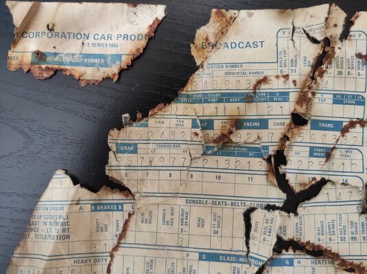

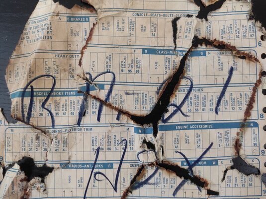

Hey guys. This here is my build sheet. Sucks so much it's partial and I'm missing important parts like the original axle. And There was wariting on the first box of the "A" packages but you can't make out what it was because you see one tiny piece of the corner.
I Really really wish I find a second one somewhere in there.
At least there are some important codes you can see. Color, engine, trans, carb, n96 etc.
V01, L1 L1 with performance painted hood.
So it wasn't a vinyl top.
Not a very fancy color but there are very few pictures online of sandpebble beige.
Carb 77 means Holley? Any way to see if the carb is the original? Also will the trans have the vin somewhere to check as well?
Furthermore seller had told me it is a "posi" car. That's "sure grip" in Mopar terms right? I completely forgot to take a pic of the rear axle to identify it.

All 4 speed Roadrunners are Sure Grip. The only thing you can identify from looking at the rear end is if it is a Dana 60 or an 8 3/4. But there may be the tag still attached to one of the bolts that tells you the ratio. There also was a tag at the fill hole that said "Sure Grip" I believe it was yellow. I'm sure some of the other guys will chime in with their wisdom on things I missed.

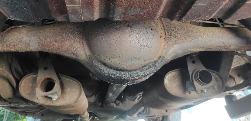

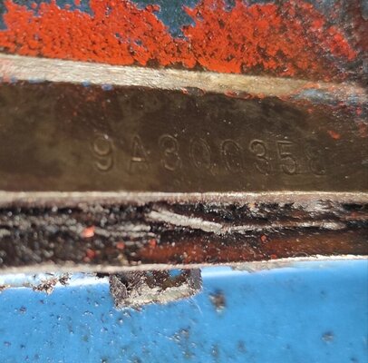

I got below the car. Some good news. Motor is the original!!
I'm not sure if the color is supposed to be blue or orange lol blue is peeling and orange is below.

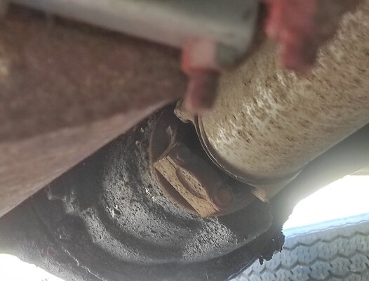

Couldn't see trans, the part where it says the vin is rusted. I need to sand it.
Most likely 8.75 rear end
I don't understand how something that is so original after all had to be revinned.

Good find on the build sheet. Too many are lost before we get these cars. What does the pun kin look like on the differential there should be some numbers on it. Or something like and X or numbers.
