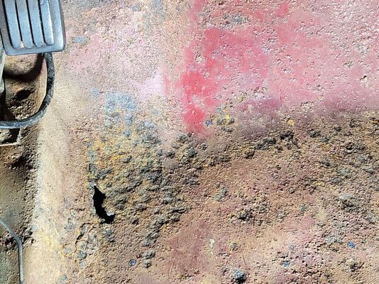

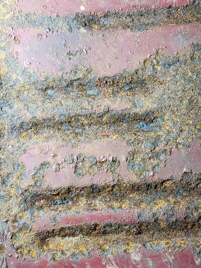

Have you got yours running? What are you planning to do with your floors and frame rails. Are you planning to rotisserie restore yours right away or fix it up and drive it for a while?
Mine is running, but not drivable. It needs 3 things. Exhaust, tires and K frame. I had originally planned to work on stripping the floor and frame, repair any rust and prime and paint, then move onto the body. I have changed course and am now working to get it drivable, then plan on working on a total restore next year beginning in the spring. I ripped the interior out because it was ripped and moldy. Found one small hole and serious pitting and metal loss on floor, so a new floor pan is on the menu. Probably by the time I get it done, gasoline will be illegal.
Seems like we're on the same boat then.
I'm looking to rent some closed space so I can start stripping. I'll try to get it running starting next month with partial disassembly of the motor making sure it's clean. And next year I'm waiting on some money, when it comes, I'll repair any damage on frame and floors, sand, prime and paint it and go from there.

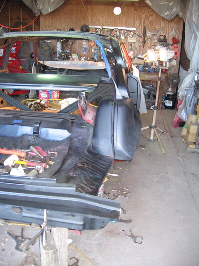

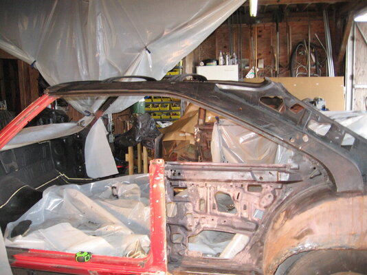

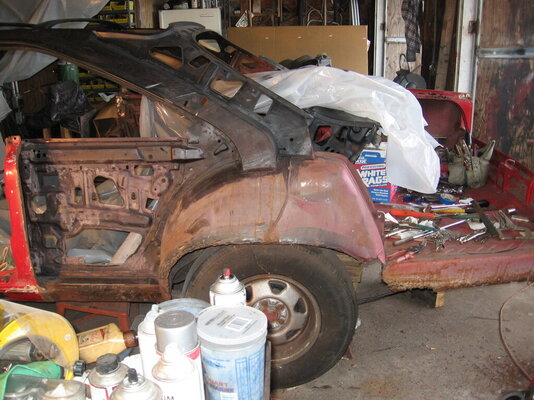

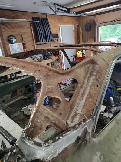

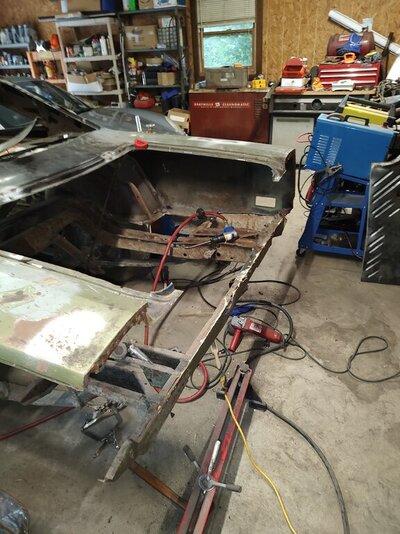

Wish both of you the best with the project. Once restored you can be proud of your labor. We all try to save what we can and keep the budget low. Sometimes we just have to bite the bullet and go for it. It is like this picture and asking myself what did I get myself into. Lol. IMG_0101 (2).JPGIMG_0101.JPGIMG_0102 (2).JPG

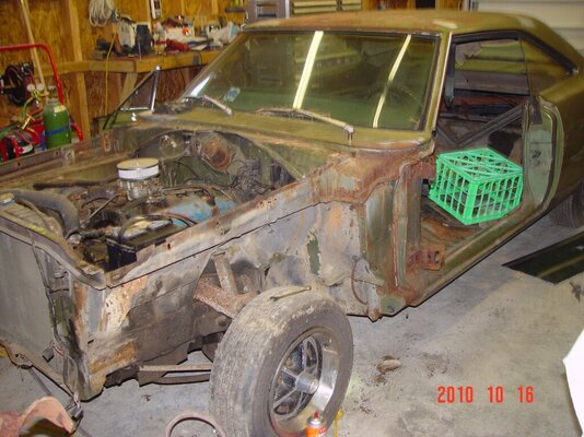

You've got the cars, the hard part is over. Make a plan and enjoy watching it progress. Take lots of pictures, measure everything. Mine did not have an interior I drove it on the trailer sitting on a milk crate. The same one in the 1st picture.

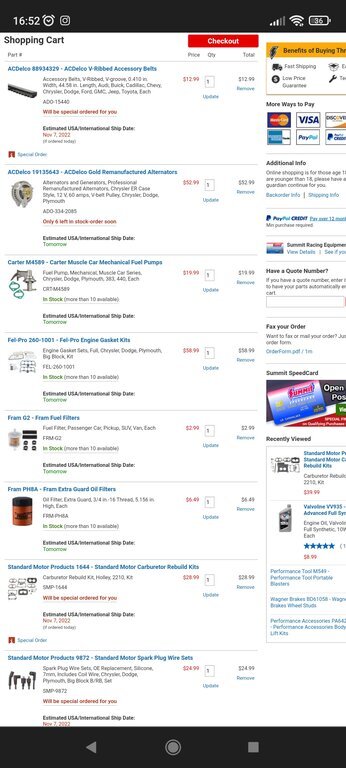

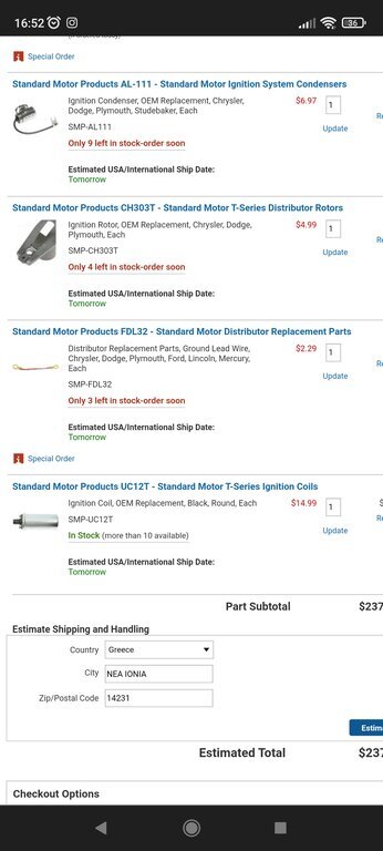

The things I'm ordering were discussed with a friend mechanic of mine and are mostly for the ignition and fuel system. A carburator repair kit, full gasket kit etc. I'll include pics of my order basket. Do you have any suggestions for other websites other than Summit racing?

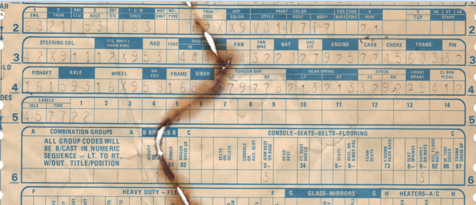

Did you find out if it is a Sure Grip?
Someone said "All 4 speed Roadrunners are Sure Grip."
Mine wasn't even though I was expecting it.
And I don't see that on your broadcast sheet.
I think you got a good thing going over there.
I'm no good at decoding these things

Yeah sure grips should say D91 up the where it says D53. It's on the part of my build sheet that's missing :(:( :'( I hope you can tell by the axle itself...
It also seems there was something on the "A" "Combination groups" on the first box but I will never know...

Determining if it is a Sure Grip is easy. jack up both rear wheels turn a wheel by hand if they turn in the opposite direction it is not a Sure Grip. If you can't turn it or they turn in the same direction, it is a Sure Grip.
